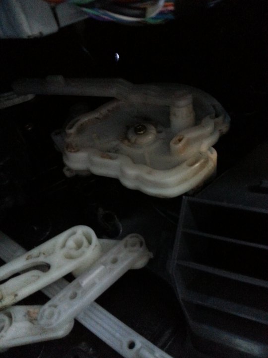

    Put heater in test mode and got 2,1 code.
    With heater in test mode, turned dial and watched servo move as I turned dial. See attached pictures with each temp dial turn. Fan did move from low to high dial turning.

    In your photos, the big, weird-shaped rotating cam in the top of the picture is part of the air-outlet servo system, the flaps and dampers that direct which of the (floor, face, window) outlets the air goes to. I can see that one in different positions.
    The simpler white linkage below that (looks kind of like straight white pieces in a parallelogram arrangement) is the air-mix linkage, controlling how much of the air goes through the heat coil and how much goes around it (and, thereby, controlling the temperature of the delivered air). I can't convince myself that linkage is also moving in your photos. Are you sure it is?

    That linkage below the air outlet server is not moving. I checked by moving the dial from low to high setting. I do hear humming noise when dial is turned. How does that linkage work? Is there a way to manually move the linkage?

    Just follow the linkage back (well, forward in the car, toward the firewall) until you find the servomotor it attaches to. If you take that motor off (three phillips screws, easy peasy) you should be able to move the linkage easily by hand. I think I suggested that in post 10. And post 15. And back in post 2 I gave a link to another thread with a video and photos of the servo motor, and also described where it's located. And also in post 4. And post 6. And post 8. And 10, and 15.
