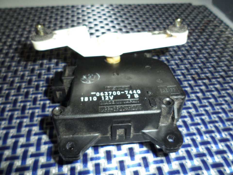

    Finally took the courage and removed the servo motor. from the picture you can see the link piece is broken in the servo. I turned the linkage manually and the heat started to come through the vents. So either the servo is bad or the linkage piece caused no heat.
    I plugged servo motor and as temperature dial turned, middle white piece was turning. This means motor is working? Lust linkage piece is broken where it connects to motor.

    Wow, that looks busted all right!
    Also weird. Is that the way it was when you took it off, with the steel pins in the ends of the white arm pointing back toward the motor?
    If you look at the video in the post I linked to way early in this thread, you'll see the white arm is normally installed so those pins point away from the motor, and insert into the slots in the movable linkage pieces. (Edit: you can see that also in Paul's video in post 25.)
    Do you remember any work done down there where that arm could have been taken off and put back on backwards? I don't think any mouse did that. :)
    Officially, I don't think that arm is sold separately, but is part of the servo unit (available here). Unofficially, you could probably scavenge one off of a parts car, assuming the motor is otherwise ok but that arm is actually broken and not just on backwards. The picture does make it look pretty beat up.
    -Chap

  11. hardish
    hardish Junior Member
    Dec 12, 2013
    2001 Prius
    No. I layed it on top for the picture. It was like the attached picture.
  12. ChapmanF
    26,244
    17,186
    I have to say that looks a lot better - though the exposure is so light that I can't really make out whether the arm is damaged at all - it's all too white to see detail. Is it possible to install it securely on the motor so it moves when the motor turns, or is there really a break somewhere?
    If it's not really broken, maybe the links had simply been knocked off of the pins somehow? It sound like Bob Wilson had that happen.
    Reinstalling it is a little fiddly because, as you can see, there's a pin at each end of the arm, and each one goes into a piece of the linkage. You have to get both linkage pieces to line up with the positions of the pins while you try to set it into place.
    The pin in the end of the arm that points more toward the driver goes in the linkage that controls the two air mix dampers (the parallelogram arrangement). The other pin, in the end that points more toward the front of the car, goes in the linkage to the extra-foot-heat damper (very long white linkage going to the pivot very close to the foot outlet of the heater). This is the damper that moves in the "interesting backflip" that the linkage does at the very maximum hot position.
    -Chap
    Paul, I just noticed in your video that it does not show the "backflip" motion and opening of the extra-foot-outlet damper at the extreme max hot setting. This is the damper with the pivot very close to the foot outlet, operated by the very long, straight white rod that runs behind the air-mix linkage to the farther pin of the air-mix servo. With the system in test mode you should see that it pretty much never moves except at the extreme of max-hot and then the linkage flips around to open it.

  13. hardish
    Dec 12, 2013
    2001 Prius
    Thanks Chap for a quick response.
    See the picture attached. The little shaft coming out of motor that goes into the link is broken. I have to either insert some plastic piece to put it back together or buy a new motor.
  14. ChapmanF
    26,244
    17,186
    Ah. Yup. New motor time. Unless you find a good one from a donor car.

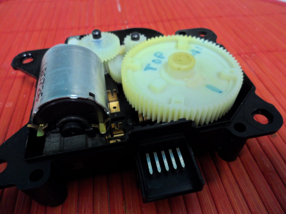

  15. hardish
    Dec 12, 2013
    2001 Prius
    Took the servo motor apart. Big gear is the one has shaft attached to. Will find a replacement motor or big gear from an auction on ebay.
  16. CrazyLee
    CrazyLee Member
    Aug 3, 2014
    153
    24
    Muskegon, MI USA
    You could clean the broken post and then JB Weld it. Dremel grind out any thing that shouldn't be there and put it back together.
    It will run forever.
  17. hardish
    Dec 12, 2013
    2001 Prius
    Replaced the servo. Heat is back on.
