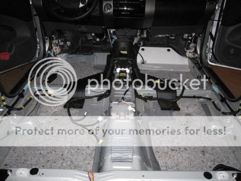

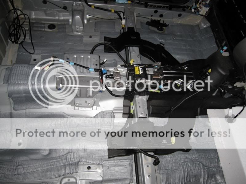

    I decided I would cover the rear seat again. So the inside of the care has 2 layers of sound blanket[​IMG]
    You can see I stripped everything off the floor so the sound blanket didnt have to be cut @ the interior pieces this is the 2nd layer over everything[​IMG]
    There is a seem @ the drivers seat where the 2 sheets overlap
