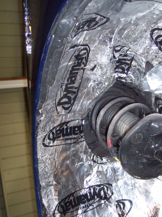

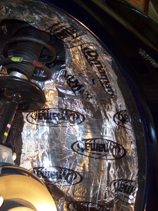

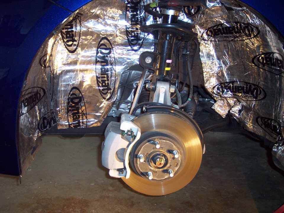

    Sadly, my car was totaled last year, but I did remove the wheel well liners first and packed the area towards the cabin with foam rubber. That made a noticeable difference. I know these pics are hard to envision as I needed to be upside down looking up in the exposed wheel well cavity packed with foam rubber.
