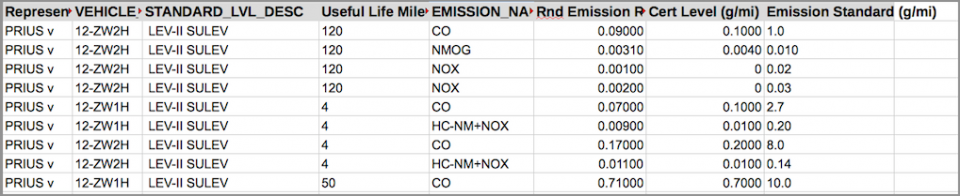

    From Wxman for the 328d:
    Emission.........................Cert.......................Standard
    NMHC……......................0.008.....................0.010 (meets)
    CO...................................0.1.........................1.0 (meets)
    NOx.................................0.01.......................0.02 (meets)
    NOx Hwy........................0.01.......................0.03 (meets)
    PM…................................0.001.....................0.01 (meets)
    NMHC+NOx (US06)…..0.12......................0.14 (meets)
    NMHC+NOx (SC03).....0.01.......................0.20 (meets)
    CO (US06)......................0.02.......................8.0 (meets)
    CO (SC03)......................0.02.......................2.7 (meets)
    And a Prius Vagon, data from the EPA
    I *think* this data is the FTP cycle, but the differences remain huge. The 'clean' diesel emits 13.3 times more (NMHC+NOx) in its OS06 cycle. Obviously not a strict comparison; I'll have to track down the Prius US06 emissions profile.
    Addendum: Found it. The US06 Prius Vagon combined (NMHC+NOx) is 11 mg/mile

    The FTP, US06, and SC03 are the three test duty cycles that EPA/CARB uses to certify vehicles. The FTP is the "base" test cycle, supposed to simulate urban stop-and-go driving. The US06 test cycle is a test cycle which supposedly simulates "aggressive" driving. The SC03 test cycle is essentially the same at the FTP test cycle, except that it simulates air conditioning use and does not include the cold-start phase of the FTP. This is the reason the standards (e.g., FTP NMHC+ NOx and the US06 NMHC+ NOx standards) are dissimilar.
    My point was not to compare the certified emissions of the Prius or any other SULEV/PZEV vehicle, only to note that the 328d technically meets SULEV based on the certified emissions.

    I know; my point is that 'clean' diesel remains an oxymoron compared to a Prius.
    I cannot find combined (NMHC+NOx) for LEV II SULEV certification. Link ? In any case, the 328d does not come close to SULEV cert by LEV III, at least in part due to the combined (NMHC+NOx) on the US-06 cycle. I haven't looked to see where else it fails.
    This is an informative link
    http://www.arb.ca.gov/msprog/levprog/leviii/meetings/030210/lev_iii_discussion_paper_2-10.pdf
    discussing LEV III. I think the final regs are close if not exactly the same as proposed except where uncertainty is noted. SFT2 requires the US06 cycle to be as strict as the FTP cycle.
