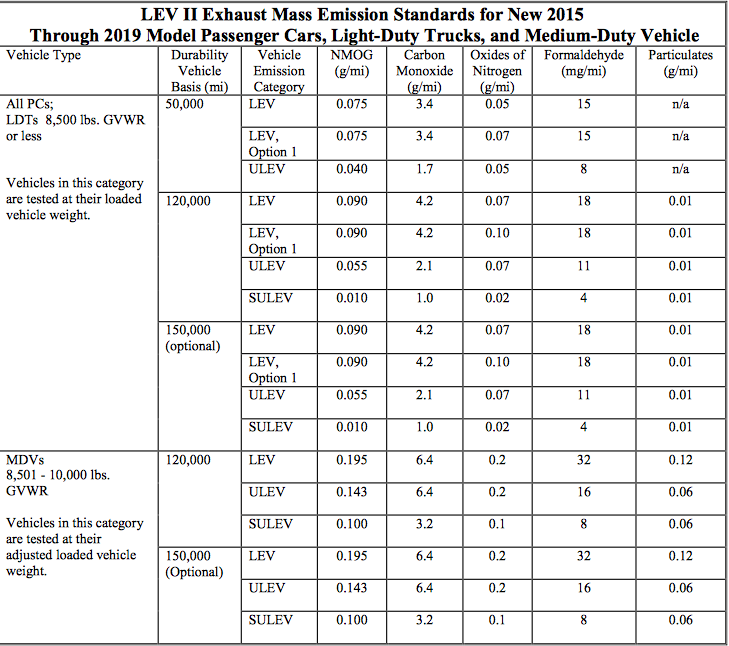

    Wxman,
    I found this table that seems to support your contention that cars may still use the much less strict LEV II for the next 5 years. If the 2015 X3 28d is able to certify as SULEV, LEV III one would think it would have been done to bank credits. BMW has a *long* way to go to meet LEV III fleet requirements in 2022. Unless they plan to start whining in 2021 that they do not have enough time.

    Diesel cars sell in lower numbers than hybrids. The potential credits from a LEV III diesel would be small. Then emission control technology is still young and evolving. It may meet the LEV III levels now, but it may not meet the levels at that 11year or 120k mile mark. Those target numbers are based on our experiences with gasoline cars' systems aging. BMW is probably playing it cautious with the certs until we have a better understanding on it for the diesel systems. Credits don't help if warranty costs are more.

    If the cars cannot meet threshold emissions for 150k miles, then by LEV III they cannot meet SULEV. Period.
    There is no such thing as LEV III SULEV for 50k miles, but not 120k miles. It would be like saying
    "SULEV, except for NOx." LOL

    We don't know if it can meet the 120k limit or not. The cars aren't actually tested out to that mileage. There is an assumed degradiation rate of the components that is used to determine the full life numbers for a bin or category. CARB and the EPA do not use separate emission limits for diesels. They require them to meet the limits for petrols. The assumptions for the petrol full life number may not apply to diesel components. BMW is making the safe bet that they will age and wear faster. If that proves to be the case, BMW saves money on warranty work, and there won't be headlines about clean diesels becoming dirty at X miles. There may be other reasons beyond US borders for certifying it to a higher standard which have nothing to do with how well the system works. For all we know, there was a backroom deal between CARB and BMW which kept the diesel at a lower certification, because CARB doesn't like diesels, in exchange for less limiting restrictions on the BEVx definition.
    The likelyhood is that it will meet the SULEV standards out to 120k miles if it can meet the 50k mile one.
