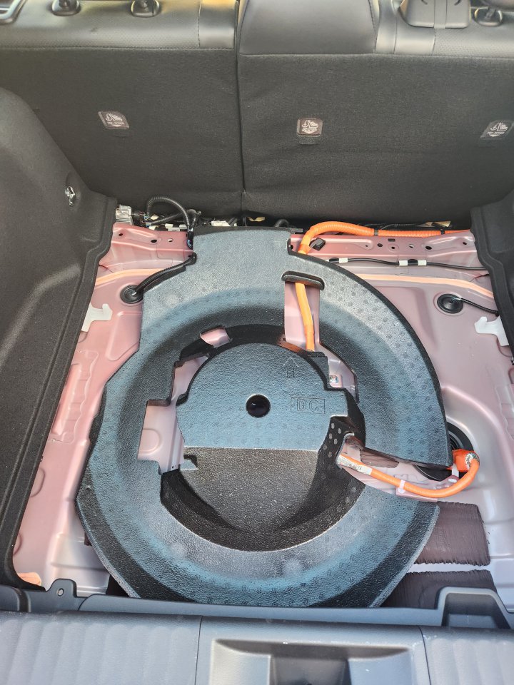

    Yes. Like I said, I don't really think it's absolutely necessary on AWD as long as you're using the black hard foam protector from my picture series as that foam protector keeps the tire away from the AWD connector on its own. But this piece of steel just adds an additional layer of protection over the connector.
    I'd say it's more important to use this steel protector if you're doing a cheaper DIY setup and cutting your own foam pieces for the tire to set on. I'll post more pics once I pick up some nuts and if it's not too cold to work outside(currently 4C and raining).

    Photos of the install. Took longer to take all the stuff out and put it back in.
    You can see in the 3rd photo that the foam protector covers the same area the steel protector does. (the 3rd photo is taken at an angle)

    I don't know. In the picture I inserted in the post just above this one, you can see that the black foam protector is shaped in a particular way. If the wheel that Modern Spare uses is different enough, the spare could lay too low or too high. It would probably be close enough that it could work with a little massaging, but I can't promise a perfect fit right out of the box.
    Note: Modern Spare offers the 135/70 for the gen5 Prius when they should really be offering the 135/80. If you ended up with the 70, it might not set perfectly into the ring molded into the black foam protector. Or it might fit just fine. I really don't know, but I thought I should give the heads up.
