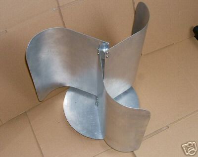

    our area may not be fast enough for wind. i was just up there.. there is a breeze.. but at that speed a 3,000 dollar wind turbine isn't going to put off much electricity.

    maybe a vertical wind generator will?

    ah... yeah.. i looked into these a while back. it's silly that i forgot about them.. low wind models and such.
