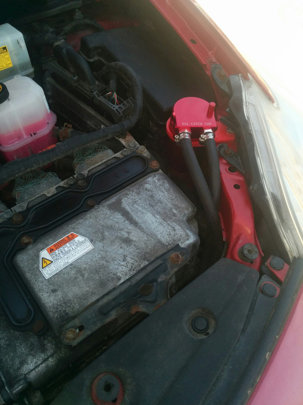

    Made the bracket from some aluminum angle stock about 3" long, back cut middle of V 2", and bent it outward to mount tank, cut top off up to the 1" chassis mount. To remove for cleaning, I'll just remove the two 6 mm oil can bracket screws.

    has anyone found another means of mounting the catch can closer? and with less hose?
  7. Mendel Leisk
    60,273
    41,471
    I mounted it with a slotted angle bracket atop the lower cross beam, below the manifold. You need to put some sort of rubber washers and lock nuts in that bracket connection though, because that beam flexes when using the front central jacking point.
    There's some pics and explanation way back in this thread.
    Access is from below, say in conjunction with oil changes.
    Raytheeagle, Bay Stater and Tbkilb01 like this.

    Oh damn me and my perfection.. Finally warm enought out so that i could install my OCC back after winter. Thought alot tube routing after removed it before winter that there was tube clamps touching water lines what are close the stock PCV tube and was not happy about it, could wear them out and thought that later spring install it better.
    Spend 2 hours installing OCC lines and removing them, installing and removing. Just could not get them the way i would accept it.
    Seems that i have to go and buy new tubes so can route them complete different way if im going to get some sleep at nights.

    @Simonak That's one brutally burnished engine bay:
    Lot's of miles, salted roads?
    Bay Stater and Raytheeagle like this.

    A few zip ties could prevent chafing, and the heat from the coolant pipes might help prevent moisture condensing out of and filling the catch-can unnecessarily in damp weather? In my Yaris./Prius C the PCV pipe is insulated by a thick foam sleeve, and is connected through a heat exchanger to keep the vapour at engine coolant temp just before putting it back in the manifold...

    My next project is to clean the engine but yes years of salty winters here in Chicago.
