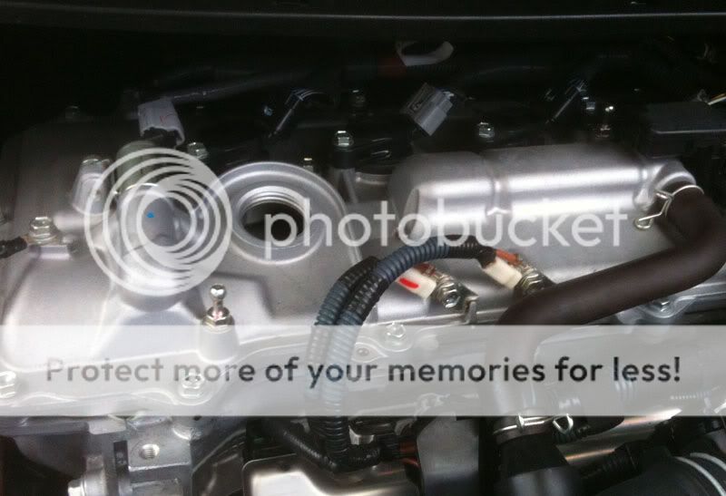

    They shouldn't have done anything at all with the spring stop, Toyota calls it a bracket clip. They should leave it alone and just unscrew the cap. Hope they didn't bend it.
    The clip is there to provide a little tension and keep the cap from coming off by itself because the cap is not suppose to be screwed on very tight, 18 ft lbs. The O ring forms the oil seal, not the cap.

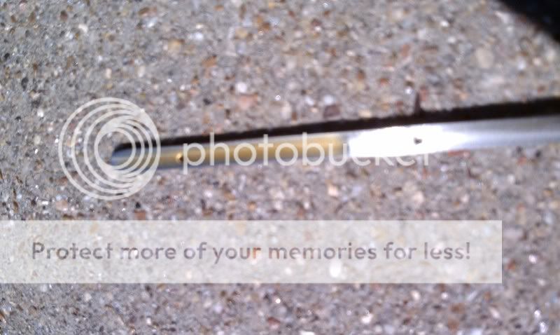

    Well I haven't changed my oil yet, when I do I plan on doing a full analysis. But for now.....here is a pic of what Amsoil SSO looks like after 23k miles.

    Just for a reference, dip your stick in some new oil and take a similar shot.

    Good idea.. but fresh amsoil will be clear on a dipstick.

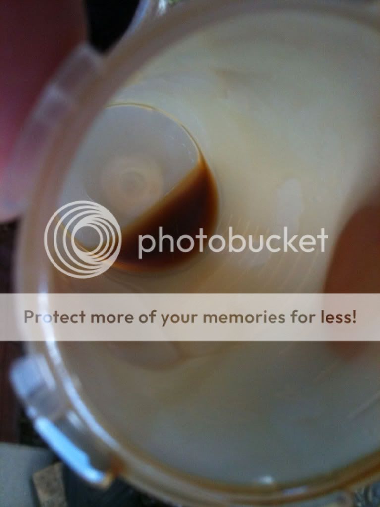

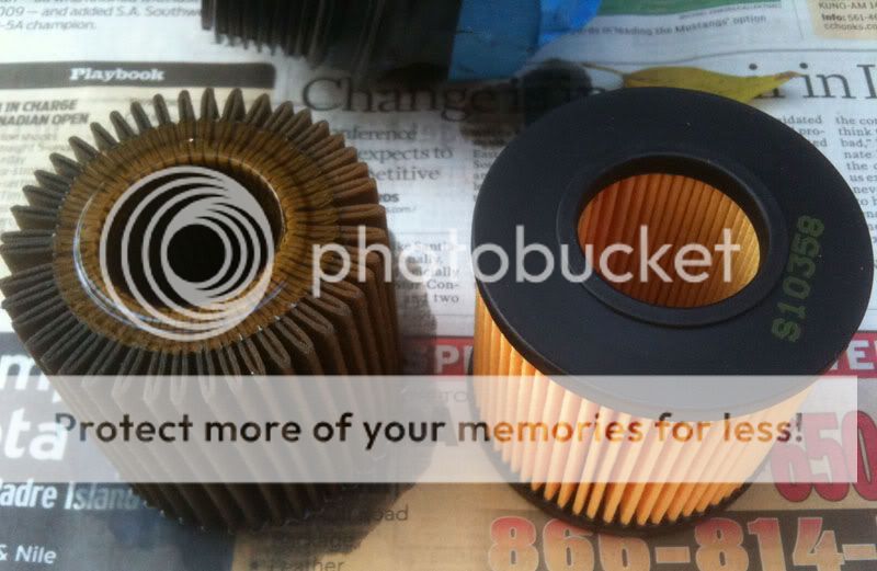

    Thanks to this thread I gathered everything I needed to do my own break in oil change @ 1k miles as there's no way I would feel comfortable letting it go to 10K miles.
    I did manage to forget to purchase a filter at the out of town dealership when I returned for my license plates so I tried to source one locally with little luck until I found an STP filter #10358 at an Advance store. It's a slightly different design and feels a little more robust with the plastic end caps. It snapped into the housing with a reassuring click.
    The only 0w20 synthetic oil I could find locally was valvoline at wal-wart.

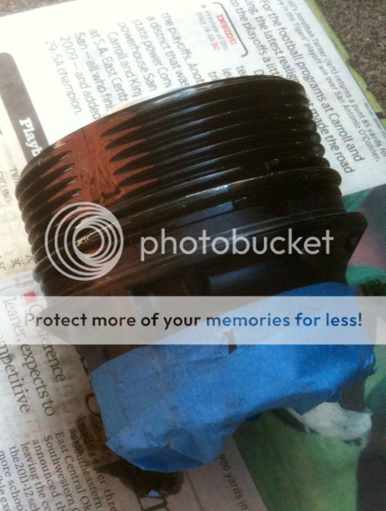

    From this thread, I also knew I had the wrong, slightly larger filter wrench and dealt with it this way:
    I wrapped the filter housing with a couple of wraps of blue painters tape which doesn't leave a residue. This took up enough slack to grip the housing and not slip.
    Another thing I hadn't seen mentioned is that the cosmetic valve cover is easily removable. I found this out by accident after discovering that 0w20 is about as thick as water and will quickly spread all over the place if accidentally spilled. :eek: No tools are needed as pulling the cover up and off the rubber grommets allowed me to easily wipe up the excess and add the last quart with much less fuss.
    +1 on the plastic access cover being easy to bend back upon itself. It's quite flexible and no need to worry about breakage (well, maybe in bone freezing cold temps) and thus no need to get the car to an exact height. I used standard one piece ramps sold at auto parts stores.
    Although the original oil wasn't black or otherwise anywhere near spent at 1,100 miles, it was way too dark for my comfort zone especially when I saw that new 0w20 is basically clear out of the bottle so I'm glad I went to the trouble.
    Thanks again to everyone who contributed. :rockon:

    The oil changing from clear to dark is not an indication that there was a problem with the oil or that what you are seeing is some kind of destructive contamination.
    There are additives and other things in the engine that will prevent the oil from remaining clear after the car is driven. Sometimes these additives in the factory oil are supposed to stay in for some minimum amount of miles to do their job helping the break-in process.

    Blanket statements usually send up a red flag for me. (notice I even avoided making one about that. :) )
    As a motorcyclist for over 30 years, I've had several bikes that have used site glass windows instead of dipsticks for monitoring oil level. I've never seen oil go that dark within 1k miles because I typically ride them in the best way possible as far as oil life is concerned: long rides where the oil gets up to full temp.
    The constant start/stop of the ICE in the hybrid system combined with the poor conditions a demo car on the lot endures means a tough start for oil. Under normal driving conditions, it should be fine for 10k mile intervals.
    Other folks think color can be very important:
    [FONT=Arial, Helvetica, sans-serif]"In many cases abnormal discoloration is a reliable field indicator of an oil that is distressed. In one study, 90 percent of lubricants that were abnormally dark were also found by laboratory analysis to be non-compliant. There are other cases, however, where a dark oil may not be a real concern. The combination of experience with the specific lubricant and routine analysis is necessary in making these determinations. "[/FONT]
    Using Oil Color as a Field Test
    Mine looked like #6 on their scale so I certainly feel better about changing it. And that's all that matters! :p

    As for bending the door, I can not agree with you about the wisdom of this. The door "hinge" is not a hinge but only a thinned out section of the already thin plastic shield. Also and the surrounding areas are backed with insulation. It is my opinion that bending and stressing these parts even in warm conditions will risk tearing the fake hinge and causing separation of the insulation, both situations are less likely if the door and surrounding areas are not distorted to gain access. I don't believe the design is robust, nor does it include bending or distortion as part of it's intended function.
    My two cents. Or $20 dollars in a few months after the fed has finished running inflation up. But won't you be glad you have a Prius when gas hits $6.00 a gallon :)

    Those plastic clips do indeed look like hell. I invariably break about 50% of those when I've worked on cars in the past, terrible things.

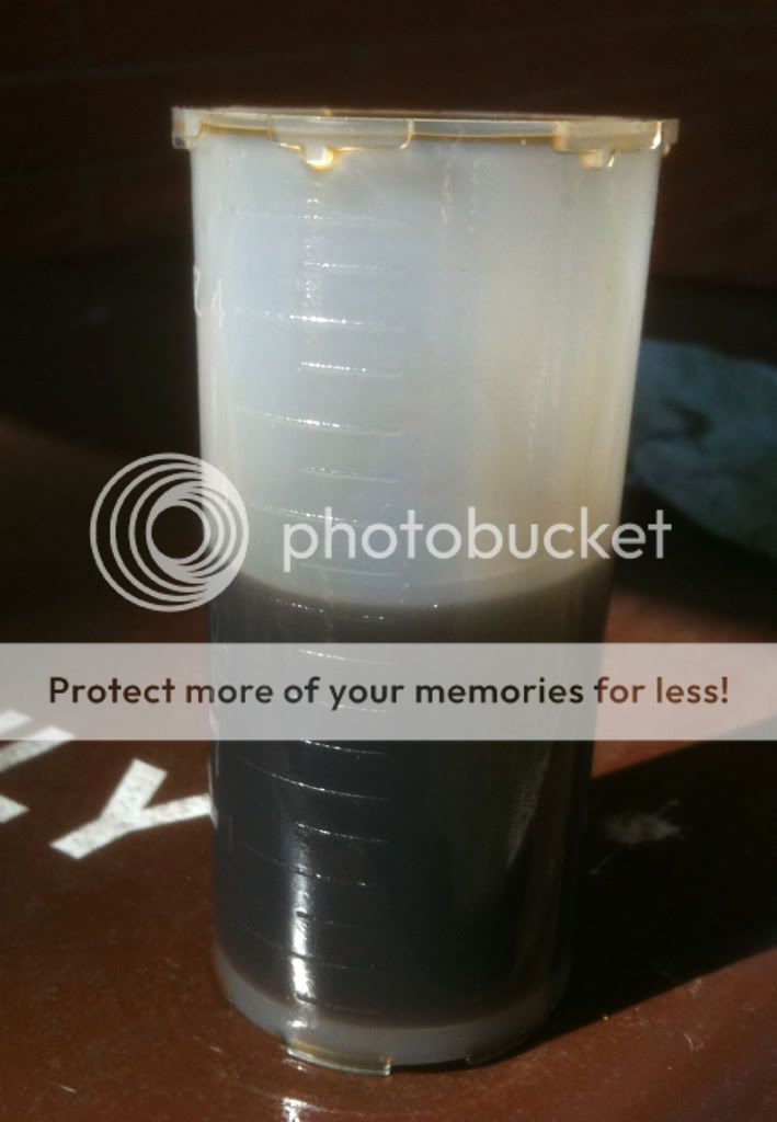

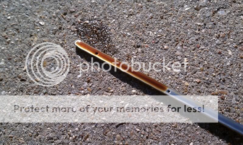

    Since we are talking about color... I know oil looks different on your finger or a dipstick verses in a cup.....
    But here is Amsoil SSO 0 - 30W brand new after an oil change.
    Here is the same oil after 23K miles......
    That oil in that last pic is now at 25K miles... I have done the change and have sent the oil off to Blackstone labs for complete analysis.. it will be interesting, especially since its hard to find results at these mileages!
    As you can see, while it still looks black in a bucket.. it actually looks pretty great for the miles!
