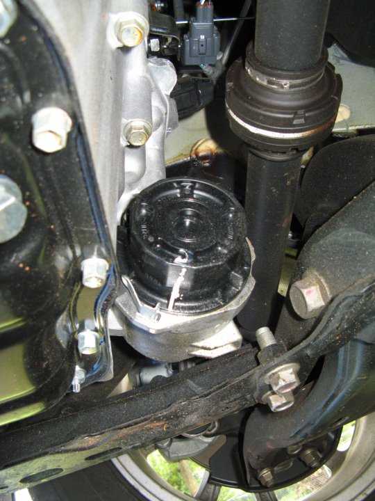

    A small 1/8" blade screwdriver works just fine for temoving the plastic rivets.
    Although I have 12 or more torque wrenches of all different sizes, my mehod of marking the position of the tightened filter cap on the engine works best and is a "no brainer." I've uploaded a photo.
    Also, I've replaced the easily pulled off rivets on the oil change door with "rivet nut" inserts and M6 stainless steel Phillips head screws.
