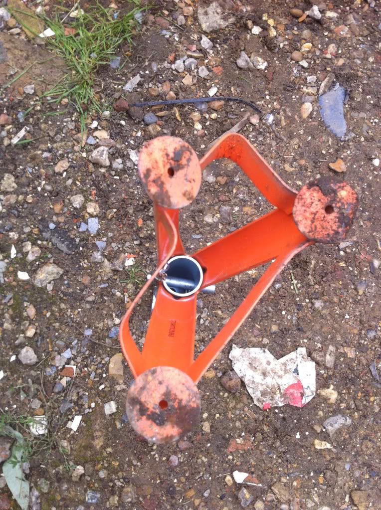

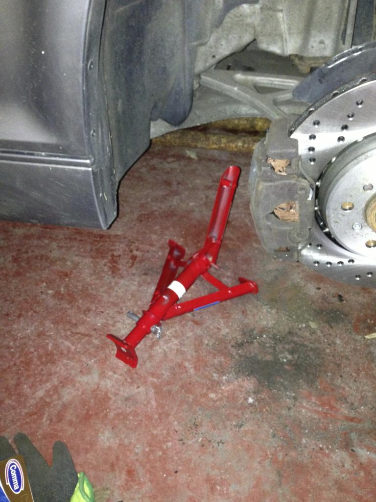

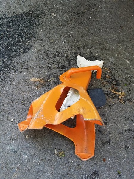

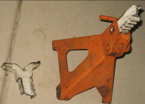

    Just for our viewing pleasure, let's look at how safe the jack stands we all trust can be, and then continue judging others for their equally safe methods and calling them names.
    [​IMG] [​IMG] [​IMG] [​IMG]
    #39 johnnyb588, Oct 28, 2015
    Robert Holt and GaryD1 like this.
