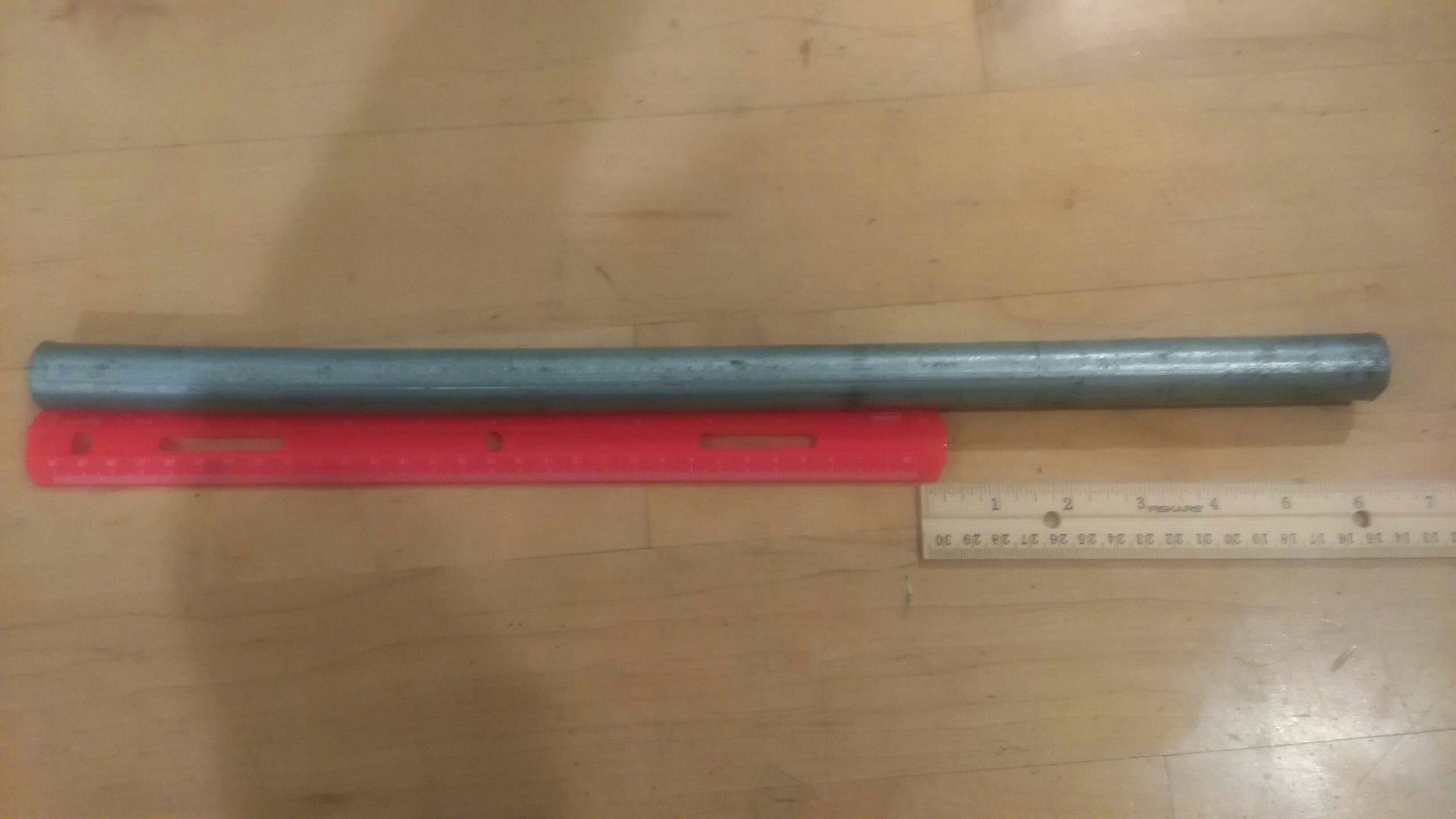

    For some reason I have this 1" pipe in my repertoire. I don't know where it came from, but it "feels" like steel. It is just over 1 and a half ft. long. Does wonders for leverage/I mean my masculinity....[​IMG]
