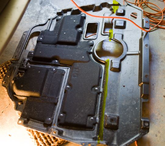

    There's actually two hinges in the engine under panel. There's a larger, full width hinge, but it would require the car to be raise much higher than a typical ramps or floor jack lift.
    Funny, we've got an 06 civic hybrid with similar under panel. It's got a hinge as well, but the plastic on that panel is about 3 times the thickness, and you could flex the hinge 'till the cows come home, it's softer plastic, more durable. That said, it's almost unusable for DIY, requires a very high lift to swing it right down.
    Here's the second hinge on the Prius panel (highlighted in yellow):

    I do not disagree that the oil drain cover could be better and heavier. I have folded mine back many times in 4 years and it is still in good shape with no signs of stress at the hinge.
    Thanks for pointing out the second hinge, I have never noticed this.

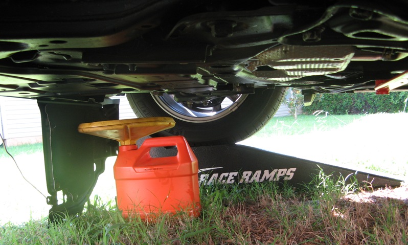

    Ramps work fine.... Here are photos of my first oil change, last year...

    Do you use any clips removal tool or just flathead? How many clips are there to remove the whole thing?
    Thanks.
