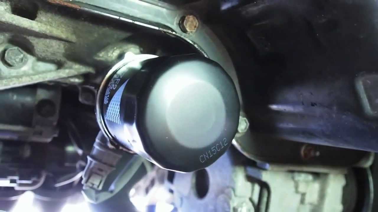

    On the 2016 Corollas, some were delivered with the cartridge type oil filters and some have regular spin on oil filters. According to the following thread, Toyota switched to the spin on filters for the 2017 Corolla. What type of oil filter do you have? - Toyota Nation Forum : Toyota Car and Truck Forums.
    Does anyone know if the Prius has switched to the spin on filters as well?
    Has anyone converted their Prius?
    The 2016+ Toyota 2zr Engine oil filter conversion - Armstrong Family Blog

    Still, regardless of it being a bit awkward (and dangerous: you CAN reinstall the housing without a filter), I like the reusable housing and just the filter being changed. Better for the environment.
    Problems with removing the filter housing can be laid at the doorstep of the dealerships: I've always done DIY, torqued it to spec'd 18 ft/lb, and never any problems breaking it loose at the next oil change. I do use a long handled ratchet wrench, makes life easier.
    Still I can see the interest, it is more convenient.
    (The pictures don't appear to be from the same car, btw.)
