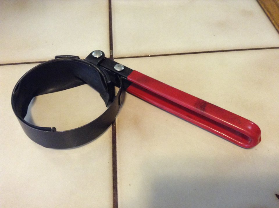

    I have another suggestion along the same lines: I glued a short section of rubber cut from bicycle inner tube on the inside of a metal strap oil filter wrench to prevent slippage . The wrench pictured below is used on my 1996 Miata as our Prius is still under warrantee and I am having the dealer change the oil.
    Agree the rubber strap type of oil filter wrench is useless, but giving a metal strap oil filter wrench more grip worked for me.
    Could anybody post a pic of that fancy Snapon wrench so I know what to look for if this does not work on the Prius?
    Thanks!
