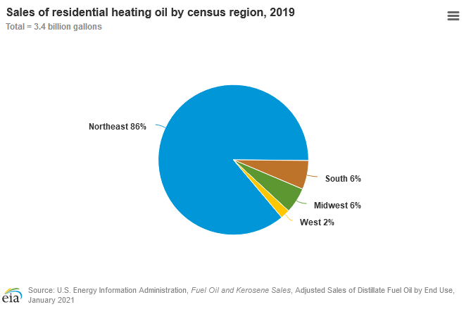

    Come to North East, you will still find plenty of houses heated by heating oil. I can't remember the number in my state, but it is more than 50% of houses for sure. And after the heating oil is not likely to be propane or natural gas nor electricity, but is wood (either cord of firewood or wood pellets). Here is the data from EIA.gov. 86% of all residential heating oil consumed in the US in 2019 is in the Northeast.
    When I had the contractor run numbers on the mini-split heat pump, he also did the estimate for a separate heat pump water heater unit. The biggest problem we encounter was that there was not enough space to place the unit in our small boiler room. Major remodeling was needed to accommodate the unit. And that only addressed the DHW, not the central heating. Did not look into much further to see if they are applicable to conversion to baseboard type hot water radiator heaters.
    Yes, that is something I am planning to consider adding some time in the future. Even though it will not cover the entire house, it will heat and COOL the space where we spend most of our waking hours. Still, this does not solve the problem of an aging oil boiler that is serving as both a central heating unit and as a DHW boiler.
