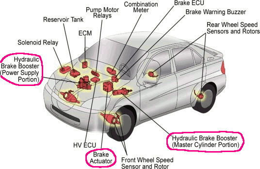

  7. rjparker
    rjparker Tu Humilde Sirviente
    Jun 6, 2008
    11,152
    6,989
    Texas Hill Country
    Brake booster components
    #7 rjparker, Jul 23, 2023
    ronlewis likes this.

  9. ChapmanF
    28,758
    19,064
    The C1252 and C1256 are a familiar pairing that tell you the accumulator pump isn't succeeding in getting the proper accumulator pressure.
    Gen 1 does not have an accumulator pressure sensor that you can read with a scan tool and see the actual pressure; it only has two pressure switches, a high and a low one (which shouldn't ever be closed at the same time, of course; that would indicate one of them is stuck, which is one of the reasons C1256 can be set).
    The procedure in the repair manual for troubleshooting C1256 has you first attach a brake pressure gauge (something with a range that can handle 3,000 psi, Toyota suggests their 09709-29018) at one of the wheel cylinders, so you can see what pressures you're getting. It suggests a quick pressure check, then a check that the pump motor operates, then checks of what pressures activate the PH and PL switches. Looks like PH wants to see 1820 to 2916 psi, and PL looks for below 1308 to 2190 psi. (I see those ranges overlap, but it seems Toyota must avoid building accumulator assemblies where the PL switch responds at a higher pressure than PH, to avoid setting this code.)
    Depending on what you find, the suggestion may be to replace the "brake booster" assembly, or the brake ECU, or fix wiring. There are 6 troubleshooting pages in the manual for this code.
    Toyota Service Information and Where To Find It | PriusChat
    When they say "brake booster" in this section, their English translators haven't paid great attention to what they officially call the parts. They mean the pump and accumulator assembly; the actual brake booster is nothing but a small chamber at the rear of the master cylinder, and a spool valve at the front of it. In Gen 3, for example, they use "brake booster pump assembly" to mean the pump and accumulator business, and "brake booster" to mean the master cylinder (which in Gen 3 includes a bunch of other stuff too).
    But in Gen 1 they used a weirder naming, where one thing is called "brake booster (master cylinder portion)" and the pump and accumulator thing is called "brake booster (power supply portion)", and that one is the one that has the motor and pump and accumulator and both pressure switches.
    C1252 just means the brake ECU has been trying to power the pump for 5 solid minutes or more, which is way longer than it should ever take to build up to PH pressure.
    So maybe the pump isn't running when the ECU wants it to (wiring or relay or motor problem), but if you hear it running, then it may be weak, or worn, or there is an internal or external fluid leak somewhere so the pressure can't build. There are 7 pages of troubleshooting for C1252.
    C1259 is one of those codes that everybody just oughtta know, so it's explained right on the blink code how-to page:
    Blink (a/k/a Flash) Codes – How to. | PriusChat
    It means there are other trouble codes, coming from the car's hybrid-vehicle ECU (orchestra conductor), and the brake ECU is just telling you to be sure to look at those too.
    Not all scan tools can read the HV ECU codes (and the HV ECU doesn't do blink codes, regrettably).
    Tim Jones likes this.

  11. ronlewis
    ronlewis Active Member
    Dec 5, 2016
    1,061
    206
    texas
    2001 Prius
    That assembly circled is the one that comes out the wheel well? IIRC, a thread said Toyota calls it a 10-hour job requiring the AC be discharged and disconnected. But one guy found an easier way, then another guy found a way he says can do the job in two hours (that means eight for me). Does that sound like the same part?
    Here's that thread. He describes the process in Post #3.
    Hi! I need advice changing the brake actuator on classic prius. | PriusChat

  13. ChapmanF
    28,758
    19,064
    Did see that thread before. In the picture posted above, notice there are three assemblies circled: one is the "brake booster (power supply portion)", one is the "brake booster (master cylinder portion)", and one is the "brake actuator".
    But using wrong names for Prius brake parts is sort of a universal rite of passage that everybody does. The thread you linked was for somebody replacing the "(power supply portion)" but calling it the "brake actuator", even though that's the real name of a completely different part he didn't touch.
    (When pointed out in that thread, the poster then showed a description from the online seller listing that had the word 'actuator'. But the online seller had just thrown in every name they'd ever heard for any brake part in the front of the car, to get more Google hits. That kind of keyword spamming is a danger to people spending money and hoping to get the right part.)
    As far as replacing the (power supply portion), or what in later generations is called the pump and accumulator, Toyota's procedure does involve evacuating and recharging the A/C. I don't remember how long they said the job should take.
    PriusChat member rlin78 was the first to post a method without disturbing the A/C, and said doing it that way took about ten hours (but saved all the fuss with A/C refrigerant). That more recent thread from Ol drippy also proceeds without disturbing the A/C, and maybe I'm missing it but I don't see anything in that post about how long it took. I'd say it wouldn't be a bad idea to clear your day before you start.
