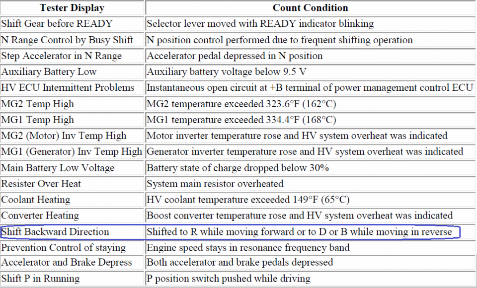

    There is no beep but the computer will record that as inappropriate operation performed by the driver (Pg 3972, 2010 Toyota Prius Repair Manual).

    Not really a problem in the US and to what end?
    Even if that were true (and I have my doubts) big T's powertrain warranty is only 60,000 miles.
    It's like getting 'secret demerits.'
    Not once in my 5 years of Priusdom have I ever heard of a warranty claim or repair being affected by these alleged codes.
    Of course this "inappropriate action" would have to lead to an engineering casualty, and under the Moss-Magnuson warranty act the OEM would have a liability burden since the computer allows the shift under some circumstances and disallows them under others.
    Result: OEM software bug. They buy me a new transmission. :)

    The few times I've shifted to drive, while still in reverse, virtually at a stop but still slightly rolling backwards, I've felt/heard no protest from the transmission. It does seem there's a soft connection, it can take it.
    Maybe faults are recorded only if the car 's going fast enough that it doesn't do the shift, beeps at you?

    Vincent,
    That is interesting that Toyota logs this as an inappropriate operation. We forward and reverse VFD motors at work all of the time with no adverse affect since they have accel and decel ramp rates that take them to zero speed before reversing.
    The fact that it shifts to Neutral if too fast is good enough for me. I will continue to use.
