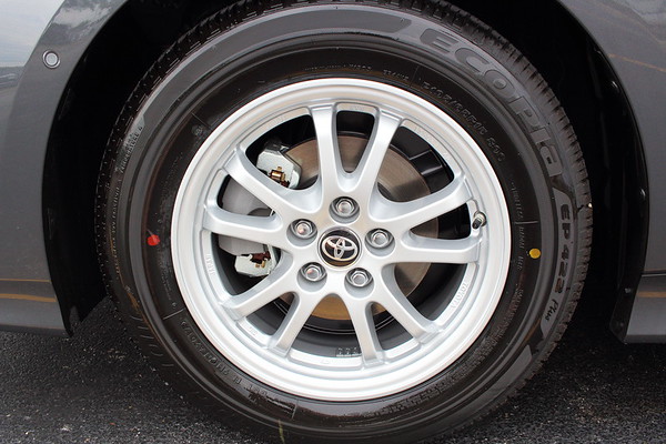

    The Prime has 15" stock alloy wheels. Still no joy at Tire Rack. They have tires, but not the 16 or 17" space saving steel wheels.

    I had known that the pattern and size were the same; more wanting to absolutely know if the lug nuts that the Prime uses might seat properly in the donut wheel.
    While out to dinner tonight in my wife's car, it occurred to me the donut spare in her car might fit mine. Lexus CT200h 2013. Looking that up now in her owner's manual.
    I'm driving the very rural back roads of NW Nebraska in a couple weeks. Extremely remote, as in, maybe no cell service rural and some gravel farm roads.
    EDIT:
    Comparing from the above attachment.
    Well, dang. Page 687 in the CT200 manual...
    Compact Spare Tire
    Tire Size: T125/70D17 98M
    Wheel Size 17 x 4 T
    Wheel nut torque: 76 ft lbf
    WINNER? I hope Toyota and Lexus share the same 5 bolt pattern diameter. I guess the only way to find out is to swap them out and see.
    A little embarrassed, but what were the chances that a compact spare being the identical size was parked just 3 feet away in our own driveway? Now, the hard part, will she notice it is missing for a week? :cautious:

    Yeah we alternate between OEM 3rd gen 17" rims and 15" Corolla steel rims (with snows). They're all the same, the inner seat at least. It's just with the alloys, the shoulder of the nut passes right through, the washer does the clamping.

    I don't know about these washers. Are there washers on the Prime alloys? I only have the one set of lug nuts. I guess I'll have to try and remove one of these to see what they're using to hold the alloy wheels on.

    The nut has both a seat, for steel rims, typically the temp spare, and a captured washer, that does the clamping with the alloys. Yeah have a look and you'll see clearer how it works.

    I had a tire dealer try fitting the donut spare to the Prime, and it looked good to their eyes. Good might be relative. To me it looked creepy and unsafe.
    Here's my paranoia about this...
    I am not so sure the standard flat-faced lug nuts that come with the alloys are the best for a steel rim that has those concave lug nut holes -- seems the flat nut surface area to a recessed hole could be a problem. Is it?
    Should I buy a set of five old fashioned steel lug nuts that look like a bullet? Would that offer a stronger and tighter fit in case I need to mount the spare wheel?

    But: there's nothing wrong with the regular alloy rim style lug nuts, for temporary use with the spare. They have a captured washer for clamping the alloy rim, and the proper tapered shoulder, for use with the spare. They look a little odd, but they work.
