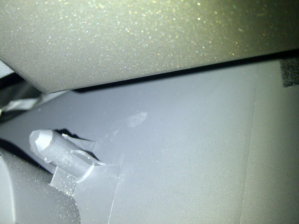

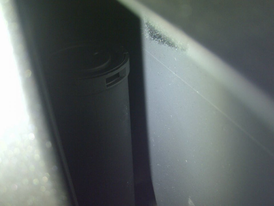

  14. Sam Dean
    Sam Dean Member
    Jun 12, 2013
    255
    here is what i could see down the side of the glove box....the first image is of the side of it when opened - the second image is of a cylindrical type instrument, down the inside - which I tried to pull downwards and it seemed attached to a metal rod - but it did feel as though it would have come down had I pulled harder but I didn't want to risk breaking anything.
  15. Sam Dean
    Sam Dean Member
    Jun 12, 2013
    255
    i think it needs a new dampener...
    i managed to attach its hook to that side latch but it didn't really contribute towards softening the dropping of the lower glove door
    I couldn't figure out how to pop the side dash compartment off so i left it....i could do with taking that off actually, because the fan panels are broken.
  16. Britprius
    Britprius Senior Member
    Jun 14, 2010
    5,194
    1,921
    Herefordshire England
    When the damper is pulled off the side of the glove box the box drops all the way down to the floor and lifts off out of the way so that you can see the heat/ac fan box and filter housing. This is how the air filter is changed. Will take pictures when I get home.
