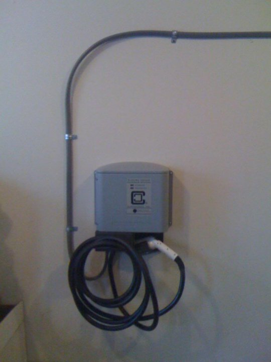

    Looks like the cable on this Clipper Creek has similar amperage ratings so the cable width will probably look similar:
  10. bisco
    115,144
    52,677
    huh, that looks a lot mike my 30a. unless i have a 60a and don't know it.(n)

    The picture I found above was for the ClipperCreek CS-100. Here is the manual on it: http://www.clippercreek.com/pdf/CS-100%20User%20Manual%2075A%20DLP%20091124%20v01.pdf
    Their web page markets it as an 18kW charger at 240V, so this EVSE should be able to provide a vehicle up to 75 A. The specs don't seem to note what the cable is rated at, but I have to assume it can handle 75 A. Still, looks like charging with a gasoline station hose.
    I looked up the spot price of copper last night, an it was $3.15/lb, so if all of the weight of this cord was attributable to copper, that would explain about $75 of the cost. Looks like copper is just one part of the high prices on these cords.
