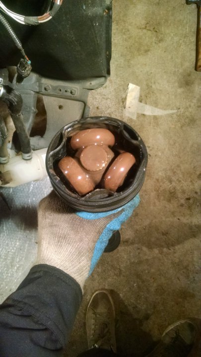

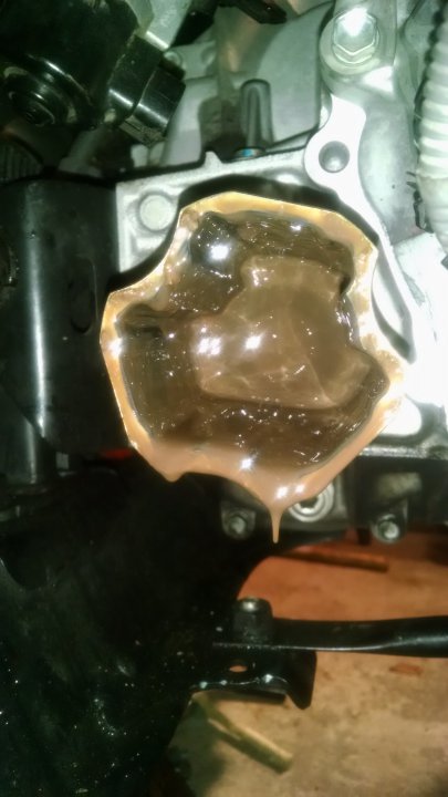

    Hey there everybody. Engine is out. Will be looking for a new used one. One question. My drive axles poped from the inner cv joint...not a big issue but would like to know what is the grease/oil in those so I can close them.
    I will attach a photi. It was prety liquidy..

  20. A617
    A617 Member
    Mar 22, 2014
    213
    95
    OKC, OK
    may have to hit the dealers for that, they may even have a cv boot kit available.
