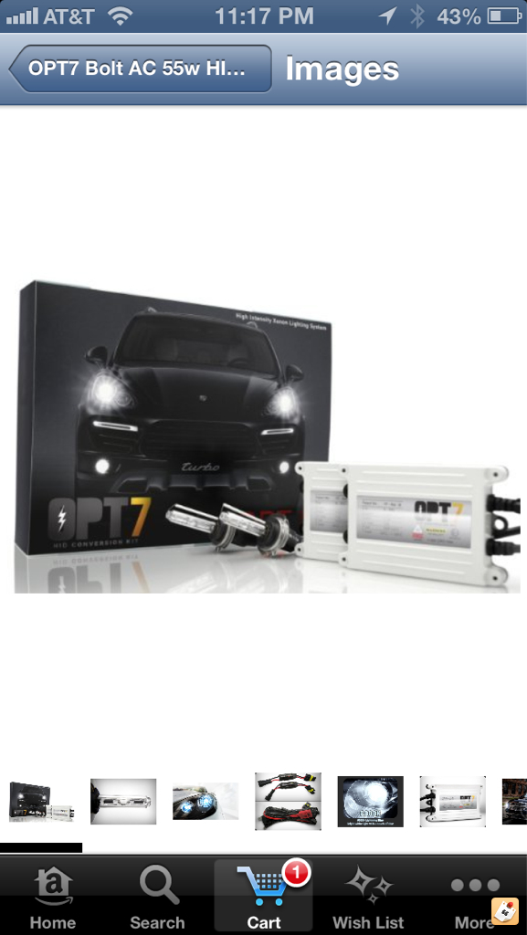

    I have found this hid kit (H11) for $69.95 at Amazon.
    Just wondering if anyone has used this before. Is this a decent good product?
    Turn off signatures in Tapatalk Tapatalk
    Screen capture from Amazon....

    you should get them and tell me how they are. i'm thinking of getting a set.

    Thanks. No wonder there is only 1 response.
    Just FYI, so far I have been using this hid for 3+ months. No issue so far....

    Check the warranty on em.
    You can get a kit from DDM for less with a warranty.
