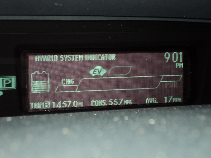

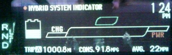

    When you are doing P&G, the secret to it is this. When you pulse, use the maximum amount of the HSI Indicator without entering the Power Zone. Make sure you glide a LONG time over a LONG distance. Only then will begin to see the big numbers. In order to do that you have to be on a road where there is little traffic. Best habit is to go with the flow, and only P&G when no one is behind you. Depending on your route, your technique will vary as you make your trips along with traffic at that time. Here in Texas we use the MPH system unlike where you are. So you would have to convert the numbers I will throw at you.
    Here are examples of speeds I use when doing P&G.
    On a 30 MPH limit road I will pulse very quickly up to the target of 32 MPH, then immediately go into a glide and glide to at least 23 or lower.
    35 MPH road - pulse to 38, then glide to 25 or lower.
    40 MPH road - pulse to 43, then glide to 30 or lower.
    45 MPH to 50 MPH - pulse to two MPH over limit, then feather the pedal until the HSI is just about even with the right side of the ECO logo on the HSI. When I do this the Prius will gradually slow down and the HSI indicator will gradually move to the left side of the middle line. By that time the speed has dropped three or four MPH, then I will quickly accelerate back up to the target and feather again. This technique is pretty much what SHM is all about. I look at the instantaneous read out and usually see somewhere between 75 to 95 MPG when doing the SHM.
    At 55 or higher, depending on my mood I might use CC if the roads are flat. But if it is real hilly I will simply use the foot feed as the CC is too aggressive on steep hills and pushes the HSI into the power area too often wasting fuel.
    Now if I am in stop and go traffic, I then EV without being in EV Mode. I am still doing P&G, but trying to use the least amount of battery possible. If I do need a boost of power, I won't hesitate to use the ICE.
    I am also one who will NOT use the A/C unless it is real hot. If I am by myself, I will run with the windows down until it reaches 94 outside. If I am on the highway, then the A/C comes on and the windows go up. When I use the A/C, I don't use AUTO mode. I set the temp at 76 or 78 and don't run the fan wide open. Even on a 100 degree day, I am comfortable. The windows are tinted with 3M tint, so it does make a difference. Of course during the Winter the temp will be a little lower than 76 or 78...
    Wayne Gerdes is the fore runner when it comes to P&G. There is a link in my signature file below that links to the article. Discusses all the different techniques and also explains how far one must pulse and how far one must glide to get certain MPG out of the Prius. I regularly see 50's, 75's and close to 100 on the five minute graph when P&G on the back roads. Plenty of them to use. The key to it is to not be in a hurry. I don't work any more, so driving is not a daily grind for me. I go to the doctors, grocery stores, and whatever else I need to do that day.
    Sounds like your numbers are pretty good. Trip MPG really does not tell you much. The true tell all is over several tanks. Trip B on my Prius shows 55.7 MPG for just over 1450 miles. Best tank so far as per my fuelly is 56.8.
