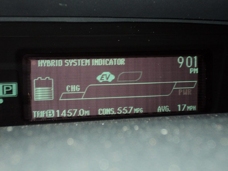

    Going back on topic, i find when i glide in N sometimes the instantaneous MPG shows 2 bars even if the energy monitor shows no arrows anywhere. Also when shifting back to D i sometimes need to step on the gas pedal a bit to try to match the drive train speed to the wheel speed. Oh and once when shifting back to D, i smelled something like a puff of hot electric motor windings or maybe hot battery smell.
    Is this normal when doing N glides? Hope i'm not accelerating my car to its point of inverter failure.

    Thanks Oz. That also answered my other question on when to shift to N. I noticed at the beginning i was shifting too soon and was probably missing on the regen when the ICE is spooling down and still putting electrons back into the battery.
    One thing nice about learning to N glide is now i realize absolute zero D glides (in the HSI bar) isn't really the regen free zone. You need to be showing a bit of of energy use (a little bit to the right of zero) when simulating regen free glides in D.

    Below 42 mph with the engine off, "N" is completely energy free. Above 42 mph with the engine running, the fuel burn is exactly the idle rate, the lowest that exists.
    There have been claims that it is possible to 'feather' with the engine spinning and achieve lower than idle fuel consumption. I have not been able to replicate it. It doesn't mean it doesn't happen, just I've not observed that behavior so we'll blame it on the "safety software patch," the current, Prius Judas goat.
