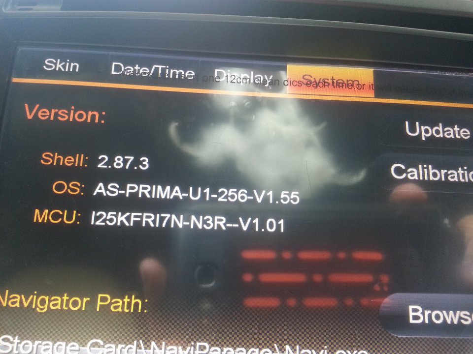

    It may be that your shell (2.87.3) is special; I don't have that particular one so I can not test it.

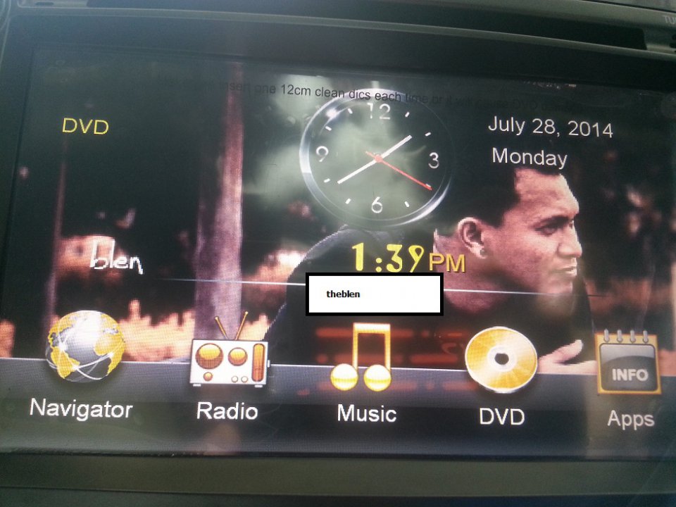

    okay i will run the explorer and copy the i9 folder for you to see
    this is the picture: 20140728_133811.jpg
  5. theblen
    theblen Junior Member
    Jul 28, 2014
    Sabah, Malaysia
    2013 Prius c
    there is DVD button on the right side of the screen so i want to change that to Movie from the Apps folder.
    i will show you the Apps menu later. right now i am driving. kinda hazard to drive n shoot LOL

    OK perfect; should work; it's the standard BlackOrange skin. Should be easy to change.

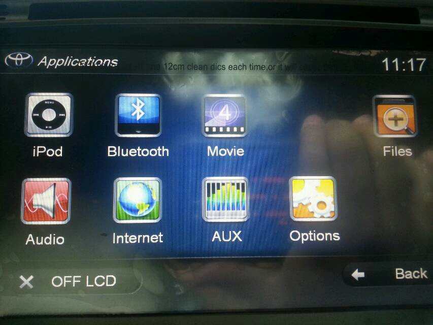

    This is how my Apps menu looks like at first:

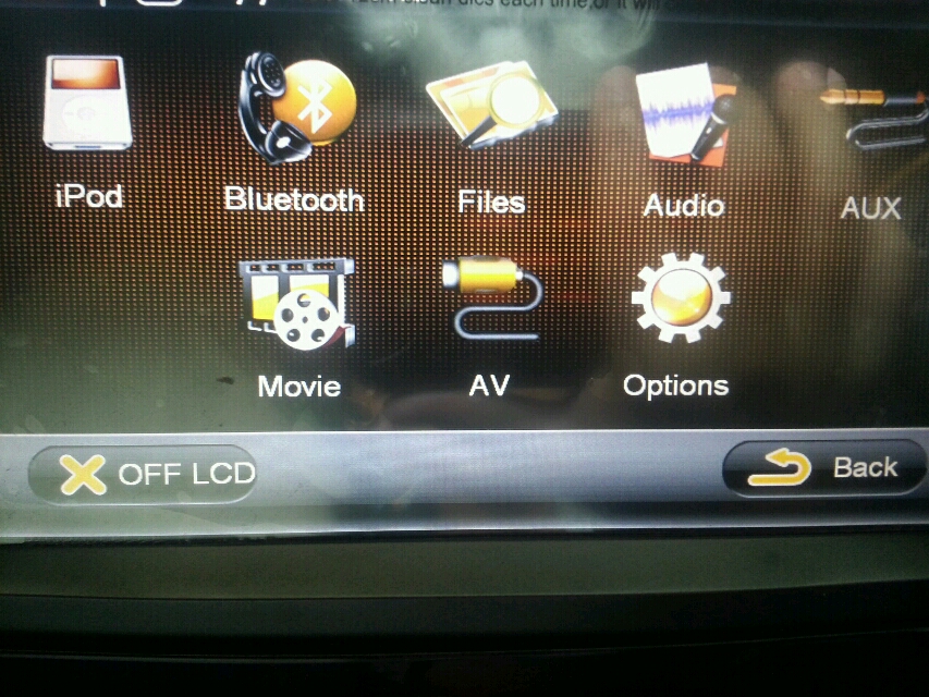

    And after i apply the skin, i miss a few icons:
    i dont know maybe the firmware is different
    but if u can help me cause i really like the Metal design, but lacks of icons confuses me. lol
    i wish i can edit on my own. haha im a slow learner

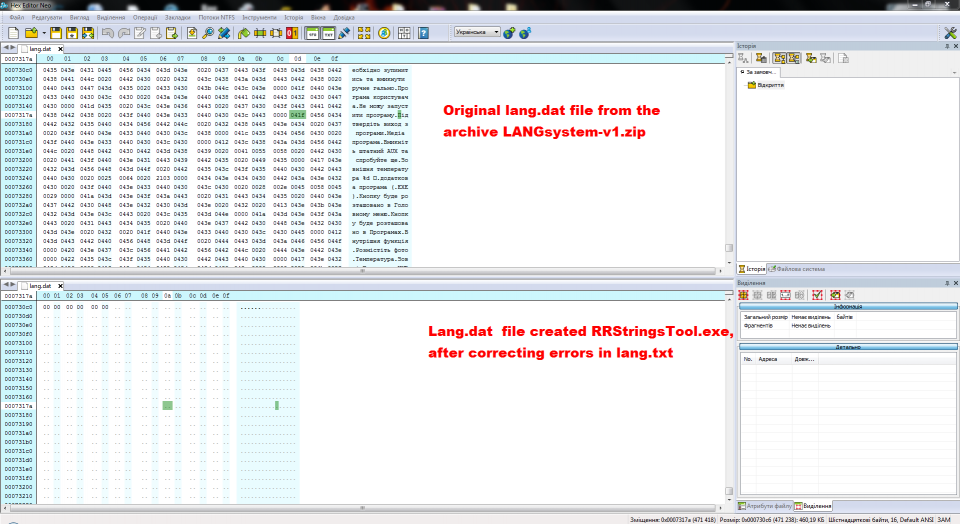

    I tried to replace the Russian strings and it were English.
    When compared using Hex editor I concluded that the problem in compiling lang.dat. As you can see on image.
    Have to edit in Hex.

    Send me the lang.txt file with the corrections and I will take a look.

    It looks like you put an extra TAB control character on every Ukrainian line.
    There should not be any special character on a line as this would be interpreted as a new line.
    So in effect you only created half of the strings.
    Please read the instructions carefully and it should work!
