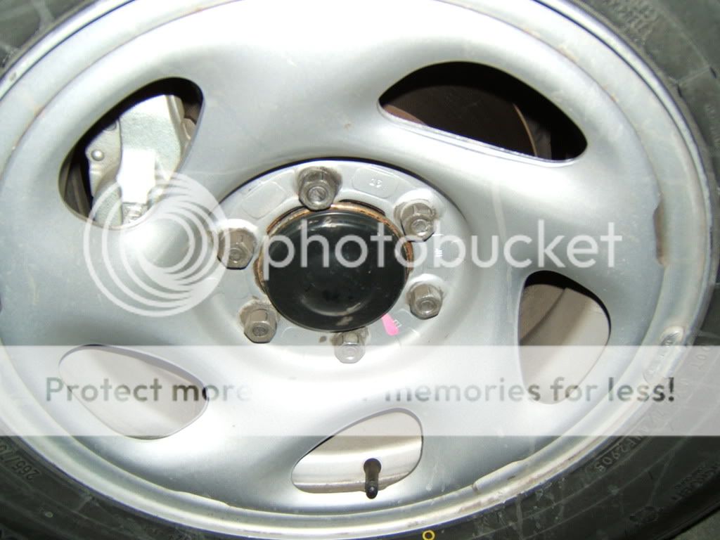

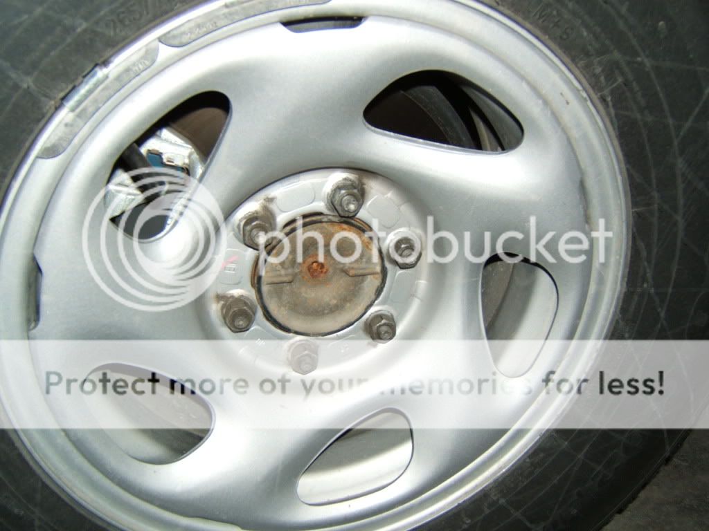

  6. alexilic
    alexilic Member
    Feb 25, 2007
    120
    18
    Wauconda, IL
    Discount tires is great in my area. They torque every lug to spec(I watch), they fill each tire to the PSI I ask with a digital air compressor(50/48), rotate and balance your tires every 5k, check your air pressure anytime you want without looking at you as if you just interrupted something important. I always shop for best price(tirerack, costco, suburban, etc.) and their prices are either same or lower.
    As for no anti-seize. As Jayman said, if you live where they use salt and especially on steel wheels, your not getting those lugs off easily. My '03 Chevy 3500 has never had an issue with me using the anti-seize. I put it on the bolts, and the rotors. I have no issues removing my wheels when the time comes. 115k miles should be enough to show signs of issues?
