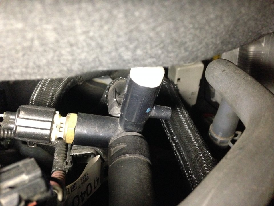

    IIRC, the 2010 does not have the self bleeder in the hose going to the heater core. Trapped air would cause that hose to be cool. My 2013 Prius v has the bleeder, and it seems to work.

    You mean this guy?
    It's kind of the opposite: in the Gen 3 liftbacks, 2010 and 2011 had it, no more in 2012 and later.
    The hose it is in, for what it's worth, is the hose returning from the exhaust heat exchanger under the car. It returns to a collecting nipple on the top of the EGR cooler and from there returns to the engine through the thermostat bypass. All of that is well downstream of the heater core.
    Toyota never said much about why they discontinued that valve with the 2012s, but I suspect they just decided they didn't need it. All the Gen 3s do have the degas-bottle style cooling system, where small nipples pick off the air from the high spots of the radiator and the cylinder head outlet and deliver it to the top of the bottle. That little upside-down U of hose coming back from the EHRS, without the extra valve, will certainly hold a bubble while being filled, but there's no law saying a bubble can't be carried with flow, and they may have seen in the first two years that it just ends up in the bottle eventually anyway, and doesn't take long enough to justify any extra fuss.

    I believe my 2013 Prius v has one of those valves, or something very similar. I don't remember the wires connecting to it though.

    Well, it looks like the same part number listed, 87251-47020, over the whole range of years, and yet people have reported seeing it with the spigot and without. I guess that would make it just two variations on the same part then.
