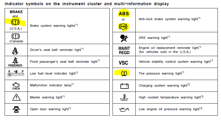

    Going back to the OP...
    What makes you think the car (AC system, engine, or HSD) is overheating????
    If the engine were overheating, you would get a thermometer looking yellow lamp, if the HSD were overheating you would have DTCs for that and your mechanic did not report those. The actuator door code can affect operation of the HVAC system, but would not cause overheating of the AC, engine or HSD.
    From another thread, the warning lights and their descriptions:
    Brake Light Warning | PriusChat

    I understand what you're saying, but the evidence was the error code happening on the hottest days while or while the engine is being pushed. I will pull my battery this week and have it tested!!
    I had that guess because the codes would always come on when the car was under load or on the hottest days. It's happened 3 times so far and 2 of those times have been when I was going up a hill for several miles and then stopped at the top and the airflow over the radiator was cut off (when my assumption was the radiator fans weren't running).
    I'll explain the 3 times this has happened to give more clarification.
    1. I was about to go to the Black Canyon of the Gunnison National Park, AC on full blast, 88 degrees outside, and driving up a hill for around 3 miles to the gate entrance, at the entrance while talking to the ranger everything lit up and I pulled off the road and turned the car off. I had the car towed out of the park that day.
    2. A couple weeks ago in boulder, CO. AC was on pretty high and I was stuck in downtown boulder between stop lights. Drove to an Oreilly and pulled codes and nothing out of the ordinary came up.
    3. Friday after I had my AC recharged I drove home with the AC on and it made it home fine the entire drive. Turned the car off and grabbed lunch. Came out and tried to turn the car on to go to work and the dash was lit up. This is the only time it had happened after teh car had been turned off.
    Looking at your indicator light symbol chart things are pointing to ABS or maybe brake master? I have noticed just this week my brakes seem a bit soft. I wonder if my master cylinder is dying?
