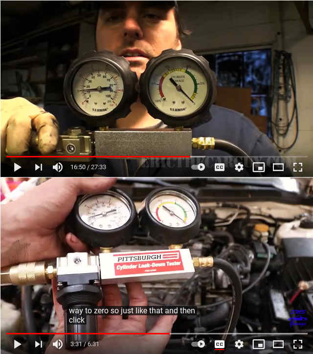

  10. Mendel Leisk
    61,521
    42,332
    Leak detector test checks for Exhaust Fumes in coolant, but that’s all? Leak down test will nail all the possibilities, I believe there’s eight .
    SicilianDragon likes this.
  11. SicilianDragon
    SicilianDragon New Member
    May 1, 2021
    27
    Is there a way to do that yourself too, do you know?
    The guy at the shop today (one of the highest-rated Toyota places) said it was pretty much narrowed down to two things at this point: fuel injectors or head gasket, and that head gasket was very probable. He left out a few simpler things, and now I'm quite suspicious that I'll be lied to if I let someone else do the test.

    There’s a special gauge set for leak down test, and you need compressed air. You can do a poor-man version, without the valve set, just using a compression tester hose with its valve removed. Full disclosure: I’ve never done this myself, just reading up.
  14. ChapmanF
    28,712
    19,010
    We seem to be driving a lot of traffic to that guy's leakdown-test video even though it's not at all hard to find better ones.
    Part of the problem with the "Eric" video is not really his fault, it's that the specific "U.S. General" tester he's demonstrating is built for a ridiculously low test pressure, so even when it is showing you leakage, you can't easily listen for where the leakage is, which is one of the main reasons you do a leakdown test. You can see in his video (and somebody else's showing the twin "Pittsburgh" tester) that these things are built so the outlet gauge is full scale when the inlet one is barely over 15 psi. The other 85 psi available on the inlet scale are just for show.
    Superficially, those testers look like the Snap-On one in the first video above, until you look at the inlet gauge and see that it is built so full scale on the outlet is near 100 psi on the inlet. That's the way the non-toy ones are built, and means you can pretty easily hear where the leakage is going if there's an issue.
    You can also get good results with the more old-school sort of tester that just uses two identical pressure gauges (instead of putting a fancy backward-reading % scale on the outlet one). You just look up both readings on the chart in the lid of the case to see what it's telling you. An advantage there is you're not limited to just one choice of inlet pressure. Again, though, you'll normally be using somewhere near 90 or 100 psi of pressure, not 15.
    The strangest thing about the "Eric" video is the way he even notices the tester isn't giving him the useful result it should give, and comments on it, then kind of shrugs it off, doesn't step back to figure out why, and posts the video that way.

    Ok, but neither of those videos have Beavis & Butthead quotes like Eric's does.
    I've been on the fence for a few weeks about getting one of those OTC devices (around $80-90, I think) just to see the state of health when I get around to replacing spark plugs. But even at nearly 159k, I have no signs of head gasket issues so it's probably not really worth it.
    Mendel Leisk and SicilianDragon like this.

  18. ChapmanF
    28,712
    19,010
    I think at the time I made this post I even saw some listings closer to $50-60 (in the OTC flavor or the obviously-same-thing Proto flavor).
    FWIW, I am in favor of getting baseline numbers around routine spark plug changes and watching how they change over time, rather than just starting when there seems to be a problem.
