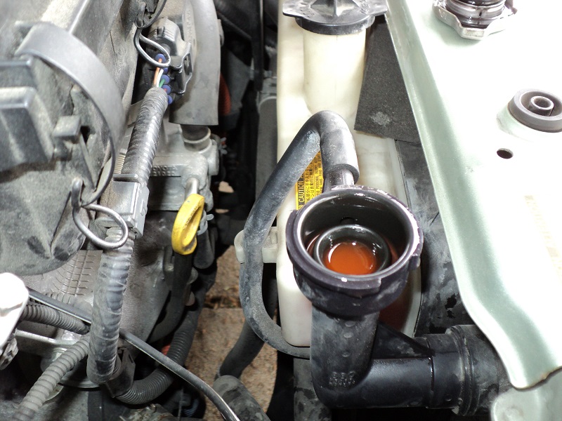

    Don't forget the P1121 code can be set if the coolant is low in the radiator. With the Prius, looking at the overflow bottle at times will NOT reveal a low coolant level in the radiator. There have been instances whereas the overflow bottle would be full, but the radiator be low. It is best to check the level visually by removing the cap from the radiator. Fluid should be to the top of the neck. The picture below will illustrate what the radiator should look like when it is full with the cap removed.
    Best of luck to you!
    Ron (dorunron)

    It took me a few minutes to figure out what you were showing but I was eventually able to confirm that the coolant does come to the top of the radiator.
    Thanks.

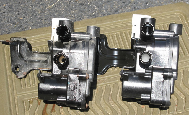

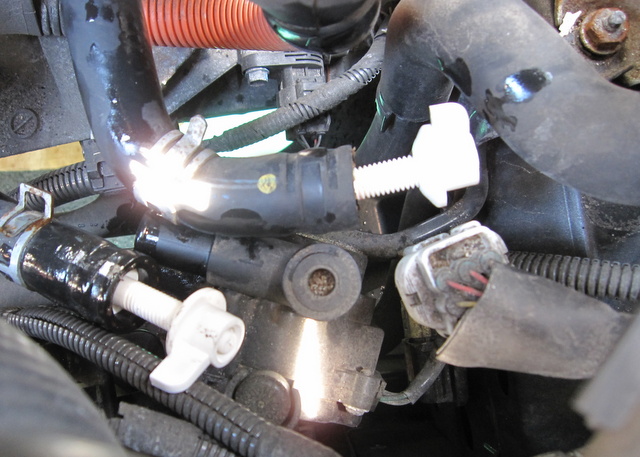

    I changed out the Coolant Control Valve this past weekend. Took my time and completed the job in a few hours. I ended up not buying the pinch off pliers. Instead, I used stuff lying around that fits inside the hoses. (Kudos to anyone guessing correctly what I used to plug those hoses)
    With this plug method, the coolant lost was minimal; at most 12 oz was lost. As for bleeding the air out, I just open the bleeder valve on the top of the radiator while adding the coolant to the radiator and the reservoir. Drove the Prius 60 miles that day with AC on. Everything seems normal.
    Here is a pic of my old and new valve.
