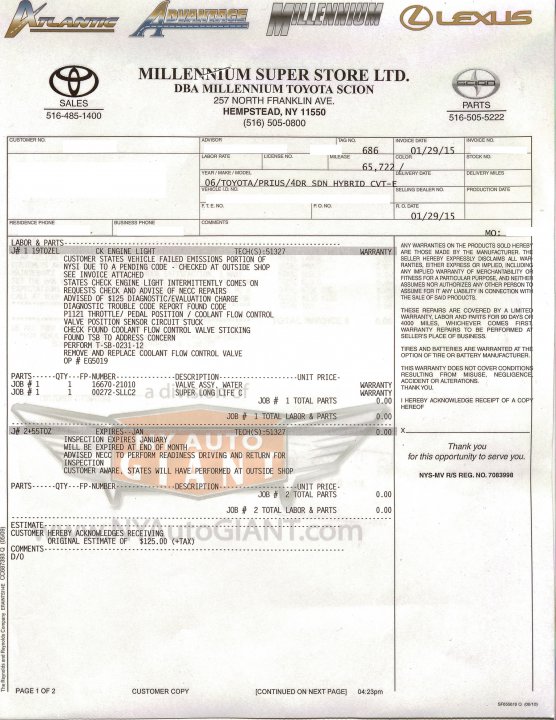

    Toyota Prius Chat.jpg Been getting the check engine light intermittently, brought to Pep Boys where I failed inspection because of the P1121 code, Pep boys did not want to do the repair because the code was not specific but Toyota can break it down. I go to the dealer and they said coolant valve and fixed it for free, I am waaaay out of warranty, my Prius II is nearly 9 years old but the Toyota service rep said it's covered under some emissions technicality and waived the $125 diagnostics fee as well- who am I to ask questions.

    Good think you are in a CARB state that has adopted the longer Emissions/Battery Warranty. Washington State is worthless-CARB: CARB emission standard adoption, but not the longer warranty of 10years/150K miles. All those folks are stuck with the shorter 8years/100K miles.
    Actually, the valve isn't listed as a covered component under the Hybrid/Emissions components. But b/c it can effect emissions the service writer/tech probably made a push. Toyota probably realized it should have been listed, but won't say outright. Instead, will cover as customers come in and dealers ask for it to be warranty.
    My 3-way coolant control valve was also covered under warranty. Jan 2014 @ 121,454 miles.
