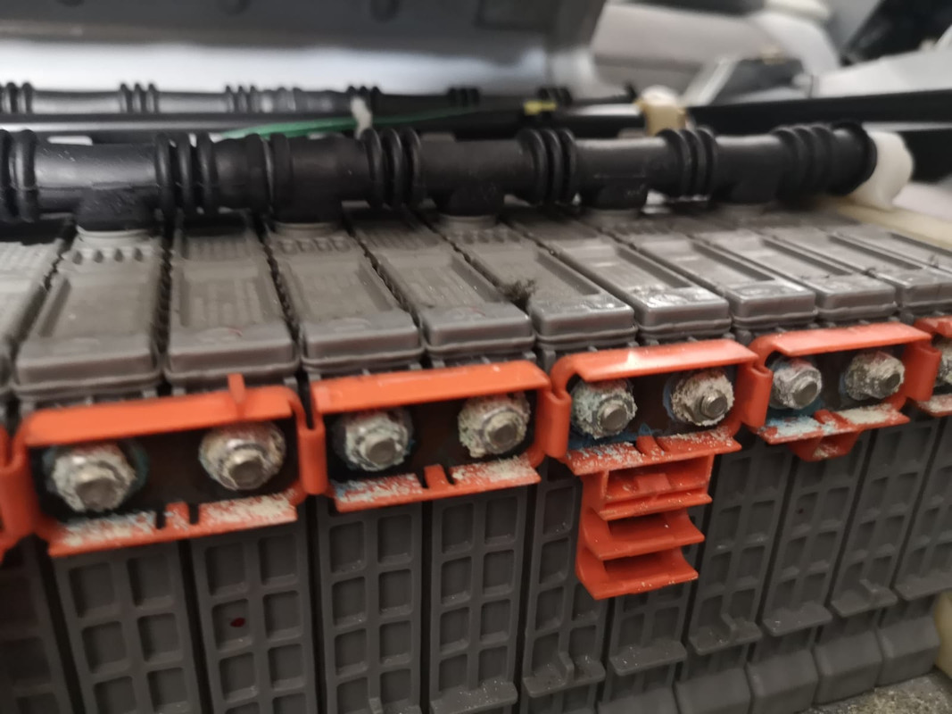

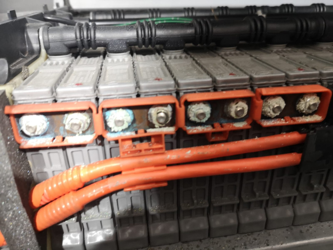

    I had some roof cracks and a lot of water in the trunk. After I drained the trunk and fixed the cracks, check engine and all the other lights came and the code was P3000-123.
    I removed the battery cover and the contacts were corroded:
    I cleaned all the bolts/plates but I still get the code P3000. When the check engine is on, the MG1 turns the ICE at full speed to drain the battery.

    might need a new wire harness, or torquing of the module nuts, if you're sure you got all the corrosion, check the cooling fan connections

    Thanks for your reply. I checked all the nuts and they are all properly torqued.
    The fan connector is deleted and the connection is good.
    I checked the voltage on all the cells and all of them are between 8.1V and 8.5V except for the 14th cell which measures 7.6V. I think that is the culprit.
