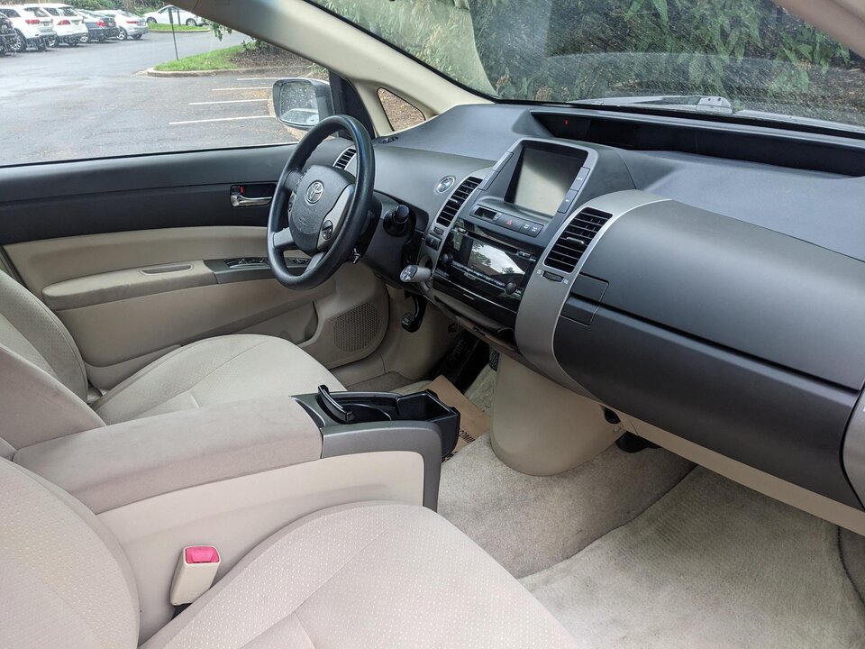

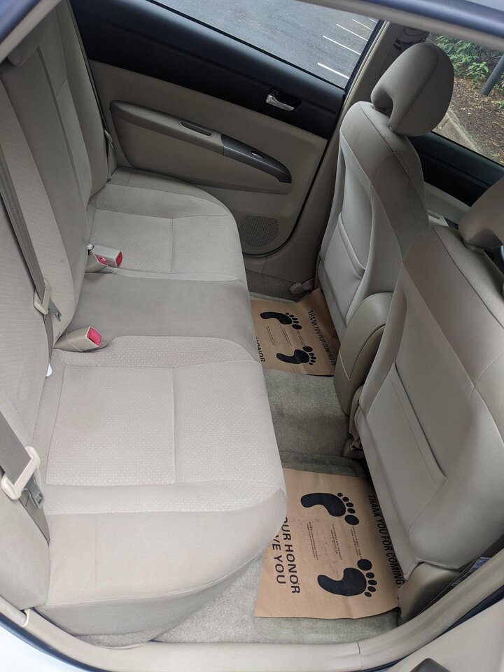

    My 2005 Prius with 94K miles is showing P3000 & C1310 codes with the red triangle after sustaining a light water damage (i.e. floodwater got into the car but did not go above the floor level) earlier this year.
    The trustworthy local auto mechanic says the range of possible issues--likely tied to hybrid battery--is too broad to be worth the likely cost of the repair ($4,000-$5,000) given the age of the car, but the car drives fine and as you can see in the attached photos, it's otherwise in a pristine condition so I'd like to at least do my due diligence and attempt to troubleshoot what could be wrong with the car.
