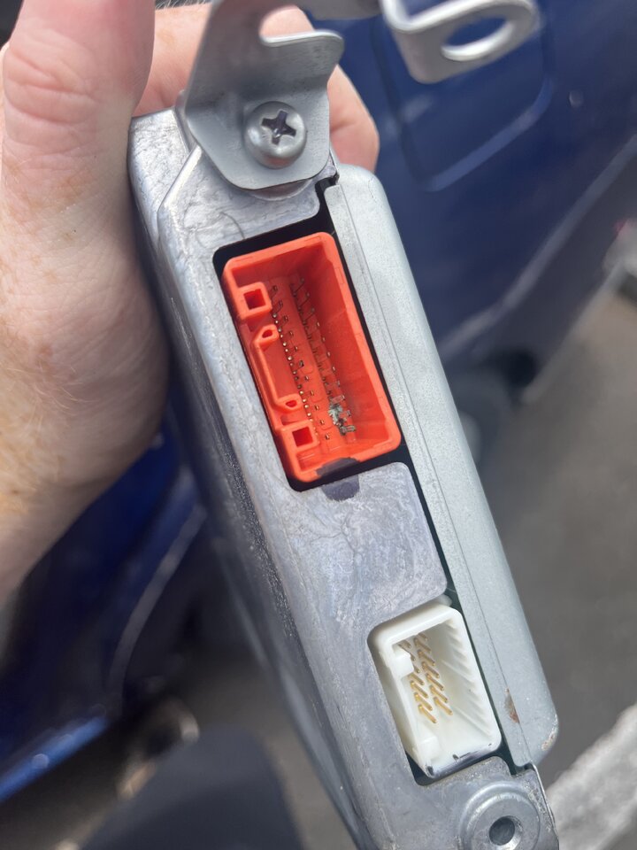

    Doing some more digging I have seen some people mention the inverter going bad. Really hoping that's not the issue.
    I've re-torqued the bus bar twice now so I don't think thats the issue and I have checked all the other connections for anything loose.
    I did have someone outside of the forum mention to check orange connector on the HV ECU as they can have corrosion issues causing over heating errors and other problems.
    I'm not going to get my hopes up that this is the fix but it does look like there is some corrosion on and around one or two pins as seen in the photos.
    Going to spend some time getting these all cleaned up to make sure I at least rule this out as a possibility.
