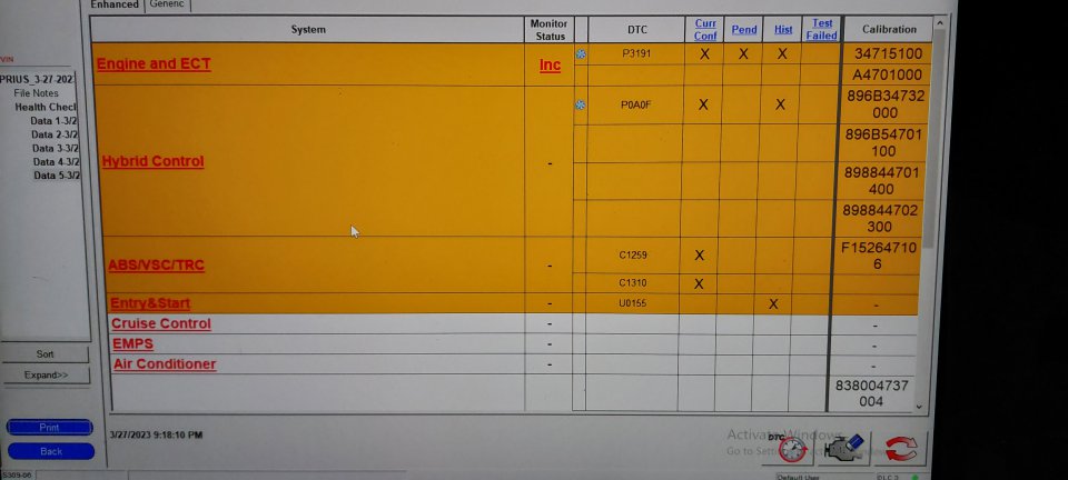

    This attached PDF is what I was able to pull from my recently acquired Autel AP200 when the error last occurred. I'm new to this granularity of data, but beyond the higher Catalyst temp values, I didn't see anything which jumped out at me as a problem when I tried googling the dataset.
    Does anything look particularly out of spec to anyone?
    The original listed error codes were the only ones found in any system after the full-scan with the AP200.

    I also do not know what all the data from the freeze frame means, but there are no misfires reported, and the short and long-term fuel trims look good. So I am guessing that rules out any problem with the fuel pump.

    It is not quite clear what this error is. What is the error number?
    Does Autel give a list of frozen parameters for each error when this error occurs?
    Is there a subcode indicating the problem area?
    Using Techstream, everything is more detailed there. List of systems, list of errors, freeze frame data.

    For completions sake, and for other users in the future: ultimately I was able to get the vehicle to fail with the same two trouble codes, while on side-streets and read detailed subcodes for the P3190, which was showing subcode 204.
