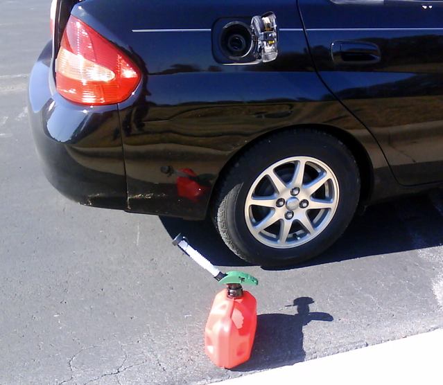

    I think what we have is misdirection around "Out of fuel." The reason is I have run our 2003 Prius out of gas over 40 times as part of fuel and efficiency studies. But in my case, I simply drove to a safe place to add 1 gallon and the car started right up. But we know from other out of gas events that if the owner tries to restart the car three times, it sets another code/latch that prevents further attempts to turn over the engine and drain the traction battery.
    The field method to get an 'out of gas' Prius to run when the owner already tried three times, is add gasoline and disconnect the 12v battery to reset all codes and the latch that prevents restart. At least 3 gallons are needed to turn off the low-fuel, flash, but I always used a 1 gallon can and never worried about disabling the low fuel level "flash."
    When I run out of gas, the car is typically, well warmed up and adding one gallon provides ~52+ miles before it is gone. So I simply drive to a gas station and fill-up. That clears the "flash" and the fuel sensor has nothing to do with it.
