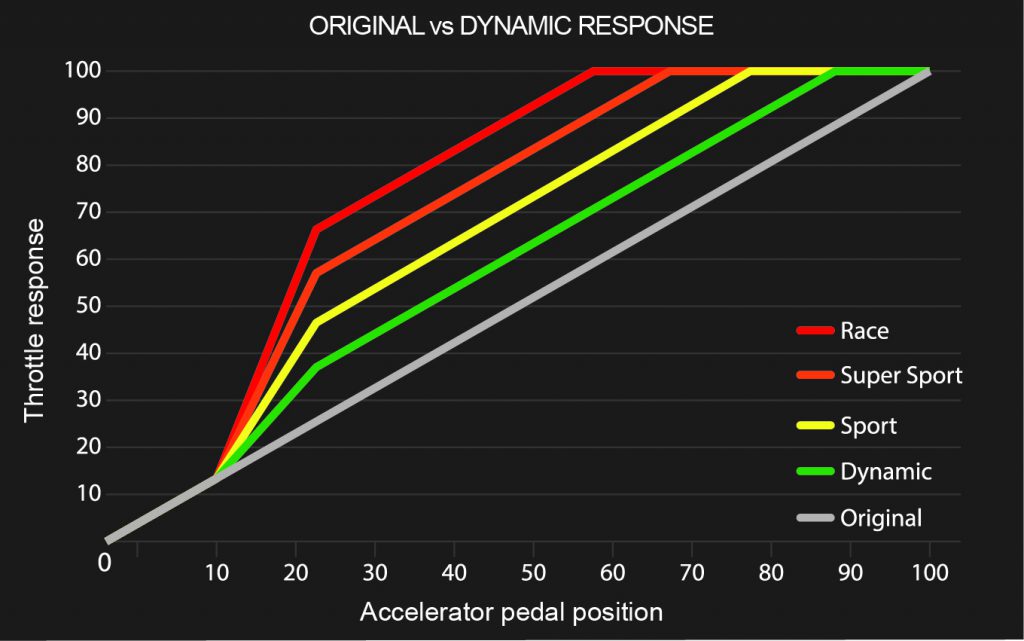

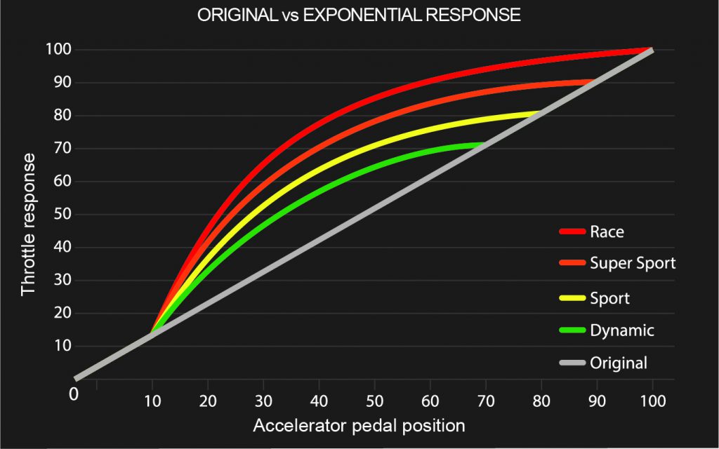

    You are correct in the sense that you can get a 100% request for power with the aggressive curve from the box when the pedal position is at 25%. But, you get the same 100% request for power with the stock pedal at 100% pedal position. So, the only thing different when you have the box installed and are using an aggressive curve is that you get to the 100% request for power in much shorter travel of the pedal. That is how it works.
    There are two voltage inputs to the ECU from the pedal sensor, or from the box, it does not matter where the inputs are coming from. Those inputs to the ECU are VPA1and VPA2 per the Toyota wiring diagram and graph shown below.
    ShiftPower-USA shows the curves on their website. They call them performance maps, which I have copied below:
    Driving mode adjustments
    Dynamic, Sport, Super Sport and Race driving modes can be configured via the App to have a personalized response with quick push button access.
    Performance maps
    In addition to the options of gain and modes, the response curves can be selected between Linear, Dynamic and Exponential, totaling more than 300 options for your performance.
    Original x Linear Response
    Original x Dynamic Response
    Original x Exponential Response
    So, ShiftPower is changing the curve compared to the normal curve. That is what I have been saying repeatedly in my posts. Your response to what i said was that it does not work that way.
    How do you personally have the app for the box configured? Are you using race driving mode with the linear response curve? I hope that you do not use an aggressive curve setting when the roads are snow-covered or icy.
    Now, tell me that is not the way it works when the website of the box you purchased says it does work that way.
