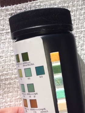

    I picked up a 2009 a couple of weeks ago (76,000 miles) off of craigslist, it was listed so cheap I thought it was a scam but it turned out to only be a couple of miles from my house so all was good.
    The records showed this car was into the Toyota dealer 5 months ago for a recall inverter pump replacement so I figured the inverter coolant was newish.
    Don't know if this pH test is indicative of older coolant but here it is.
    From left to right:
    Far left side is from the Prius radiator.
    Next over is from our 1993 Camry this has Prestone extended life in it and most likely has the same mileage on it as the Prius.
    Next is the coolant from the inverter reservoir.
    And on the right is new Zerex asian coolant.
    As you can see the newer Toyota coolant and the new Zerex coolant show a pH of around 8, the Prius radiator coolant shows a pH of around 7 and the Camry around 6.5
    I was expecting to see just the opposite but the coolant seems to age to a lower pH not higher ?
    Tim

    Yes, the coolant turns acidic as it ages, hence a lower pH reading.

    Ahh I had it wrong I was thinking a lower number was more alkaline but just the opposite now I get it and yes time to change it along with the trans fluid.

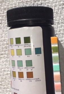

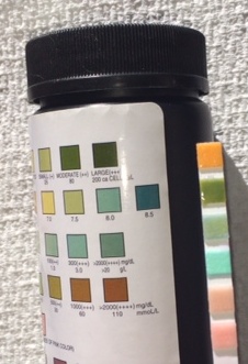

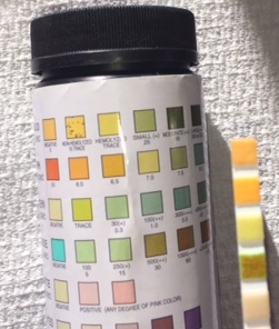

    I did pH testing a few months ago with similar results to OP:
    #20
    As promised, pH testing:
    1. Coolant from Inverter Reservoir, ~ 50k miles use
    2. New Asian Zerex Coolant
    3. Ruby Red Grape-fruit Juice
    The strips are "URS-6L," made by teco diagnostics as a urine dipstick. The pH test is the second from the top and ranges from pH 5.0 on the far left to pH 8.5 on the far right. The test relies on color change of bromothymol blue and methyl red to pH. This is a variant of the 'universal indicator' method.
    Conclusions:
    1. Ruby Red Grapefruit juice is safe to drink, at least pH wise. The color change took time, so we are not reading the color of the juice. The strip appears to be working.
    2. New Asian Zerex Coolant is alkaline
    3. Used SLLC is slightly alkaline. Time to replace ? I think so.
    View attachment 71135 View attachment 71136 View attachment 71137
