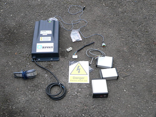

    Okay - here's an update.
    I went to the local Battery shop yesterday to get some cabling and came back with a couple of candidates. I've got to try them out and check they're not too thick to use with the 175A anderson connectors I'll be using.
    This morning I decided to take a photo of everything ready to go in - minus the car and the batteries (since the batteries are in my garage and I wasn't going to lift them out on my own!)
    My initial impressions of the Zivan is that it's HUGE! I didn't quite expect it to be as heavy as it is. I would love to plug it in and get it going, but there's no point yet...
    I also have a bit of a mac-based surprise too - but more on that when I get those bits and my car back! :)

    funny
    when i got the zivan i expected it to be bigger haha
    do i see 3 hybird interfaces boxen?

    I'm glad it's no bigger - otherwise it wouldn't fit where I want to put it!
    There's only 2 parts from Hybrid Interfaces - the CanView and BMS +. The third project box is one I'm using for my own adaptor interfaces.

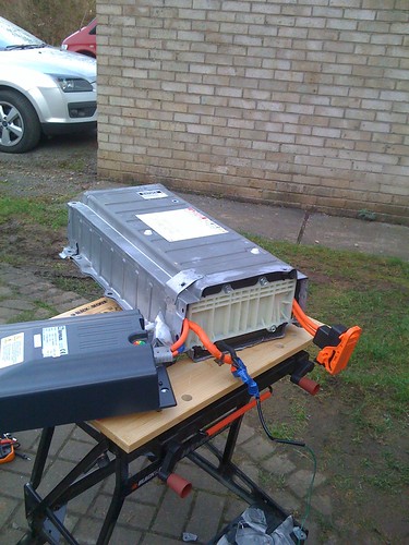

    After a week off work (it's school break here!) I was able to catch up on all my chores plus spend a day or two progressing the conversion.
    This afternoon I spent some time trimming back the battery cases (after removing the OEM BMS) - and put on the new battery cables with Anderson connectors on them. This will make it easy for me to connect/disconnect the battery packs and charger.
    For fun I also boost charged both spare batteries and all is well. It was the first time I'd used the Zivan!
    There's a photo-set on Flickr. It's getting to the point where I can finally envisage driving around in my plug in Prius!
    Prius battery preparation - a set on Flickr
    I had better hurry up anyway - I have to exhibit it at the maker faire in three week's time! :shock:
    Nikki.

    Very cool! Can't wait to see it up and running. I'm sure you are already aware, but just make sure when trimming the cases down you don't compromise the parts that keep the battery modules in compression. Without that pressure, the modules will expand and pop like pop-corn during charging as internal pressure rises.
  19. Flying White Dutchman
    Dec 29, 2007
    4,376
    313
    miscrms
    the 2 plates holding the battery's and used for the compression are connect with 4 (2 on top and 2 bottom ) steel pipe's
    the battery's are only connected to the base plate to hold them down
    you can cutt that compleet case away and still have the pressure hold.

    Thanks! Yes, I have checked that it doesn't affect the battery compression blocks. I've actually just cut shy of them, so there should be enough metal left to stop the exploding!
