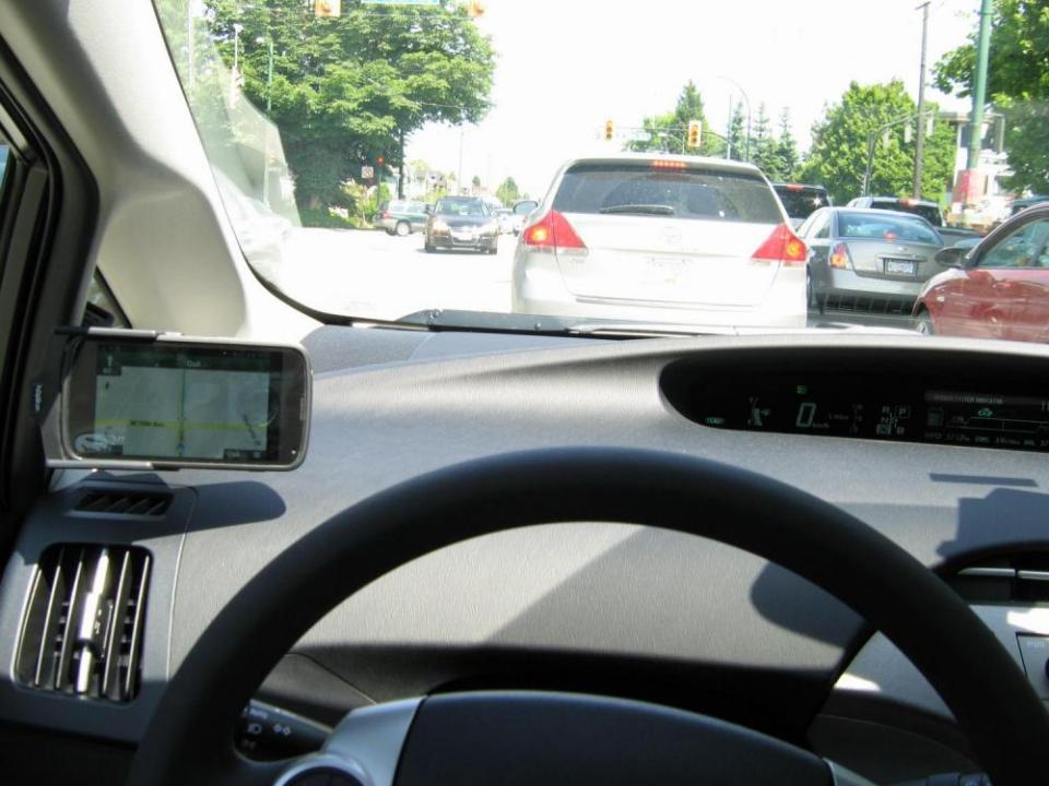

    The end result looks like this:

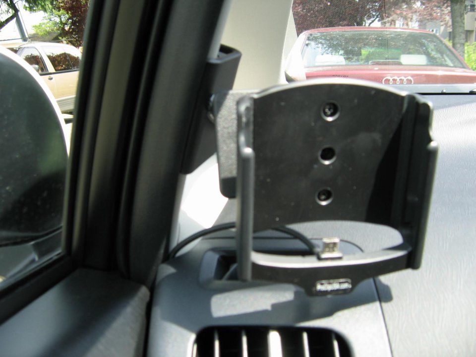

    And the only visible part of the power cable is this:

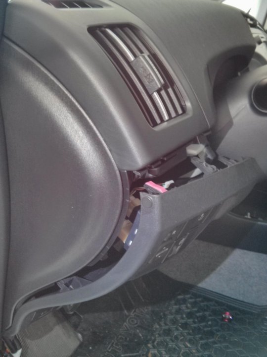

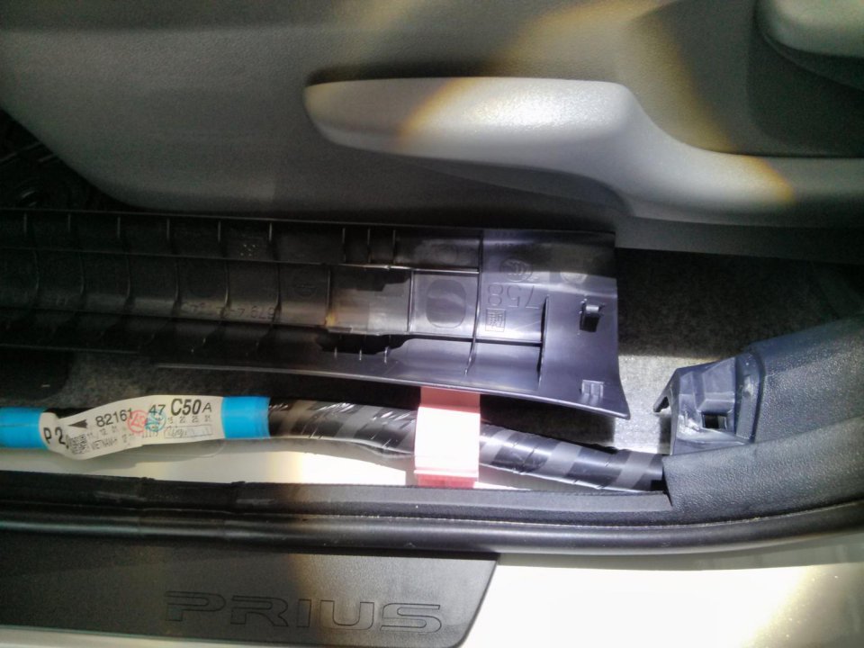

    First, remove the plastic cover on the door sill. Pull with your fingers on the inside edge to unclip the inner side. Then lift it up to unclip to remove it.

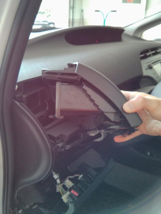

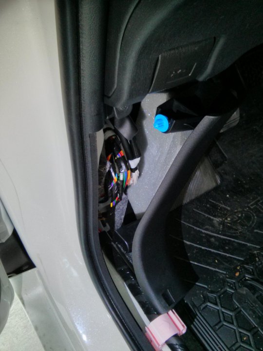

    Now we can move on to the piece just forward of that one that was partially underneath what we removed. This is secured by a screw near where your left foot rests. Remove that and then pull to unclip the 2 remaining clips (you can see one of them in blue in the photo):
    Now that frees up the next cover just above it. Pull to unclip it.
    With that out of the way we can remove the final item. It just slides right out.

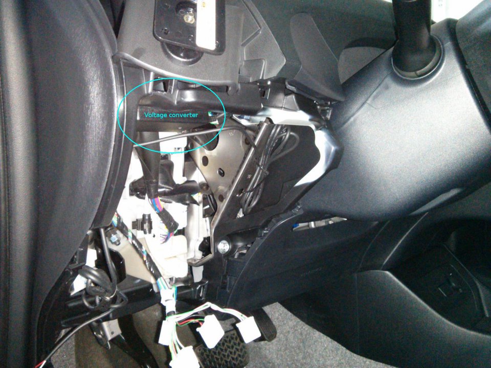

    The ProClip came with a voltage transformer to convert from 12v to 5v. It also came pre-supplied with a 3M sticker. Inside the dash had a perfect spot for it. Peel off the backing and voilĂ .

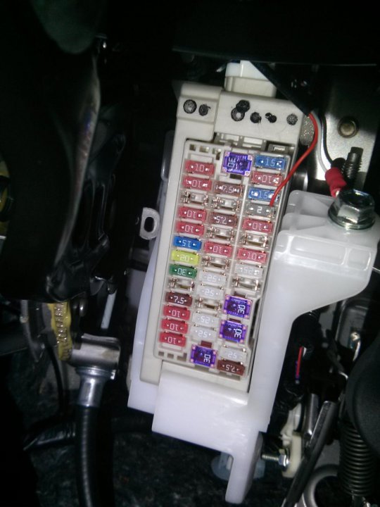

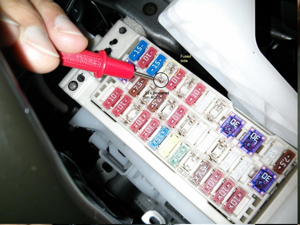

    Now all we have is the bare end of the wire begging for some 12v goodness. In the fuse block near the 15A CIG and Power Outlet fuses there's a spare slot that is powered in ACC and Ready modes. Perfect for what I wanted. The inner side is powered and the outer side is fused (marked on the photo).
    I wanted to plug directly behind the fuse block, but couldn't see how to access it. If anyone has any tips, do share! Instead, I just stuck the wire right in with the fuse. Not pretty, but with the cover on it's not exactly visible, either. Red to power; black to ground.

  3. bisco
    115,366
    52,807
    that's better, well done! i like it clipped there. looks out of the way, but easy to view at a glance. is it part of the door, or fixed portion ahead of the door?
  4. mactalla
    mactalla Junior Member
    Jun 16, 2013
    It's attached to the frame of the car, not the door. So the phone remains stationary even when the door opens and closes.
