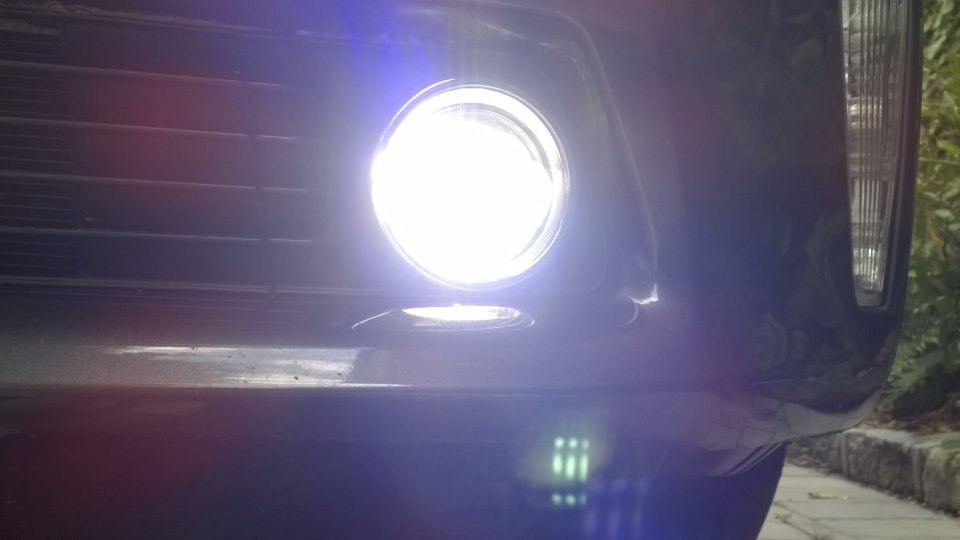

    It's 5000k, so it should be bright white. I believe it's just the pic that makes it look purplish. If you scroll to the later pics, theres a cutoff pic that looks bright white against the wall.

    That's actually a change. The earlier ones were in fact 6000k 'purple', and when I asked about 5000k or 4300k, was told 'nope'.

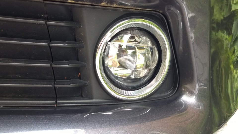

    I don't see how PIAA can claim that their LED bulbs have sharp cut lines/cutoffs, as that would mostly depend on the optics (reflector, lens, etc) of the lighting system the bulbs are installed in.
    The Prius oem foglight is reflector based and simply lacks a sharp defined cutoff. If you are willing to spend $200, then a good projector or the LED foglights above would be a better buy.
