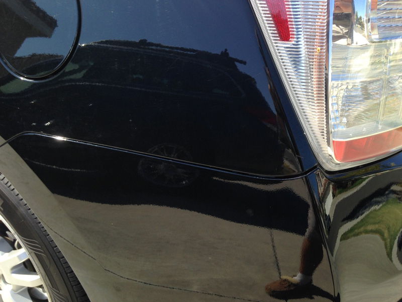

[pics] Passenger side rear bumper gap. Is this normal???

    Not sure if I'm missing something here, but looking at the photo in the first post I really don't see where this terrible gap is. It appears to look similar to a lot of work on newer cars. I looked at mine (a 2014 Sea Glass Pearl) and while it looked like the photo I didn't think there was anything wrong with it. Does anyone have a pic of what it should look like?

    I know Oscar. That is the reason why majority of technicians answered just like you. it is very slight difference. But I can say it is noticeable.

    I can appreciate and relate, but still, does anyone here have a photo of what it's suppose to look like and compare it to the photo in the first post of this thread. And really, we're not talking about a handmade Bugatti Veyron here. It's a Prius! Even Consumer Reports has consistently pointed out flaws it its fit and finish. If I have one that supposedly has this gap, well, I can live with it. No big deal. But if that audio system dies, then that's another story!

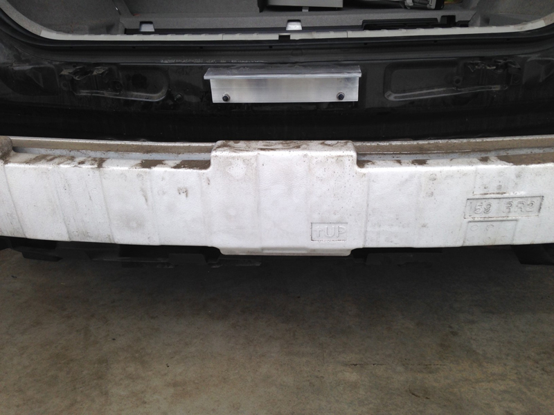

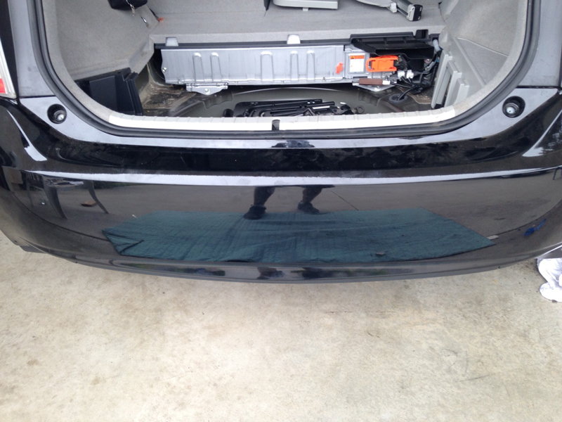

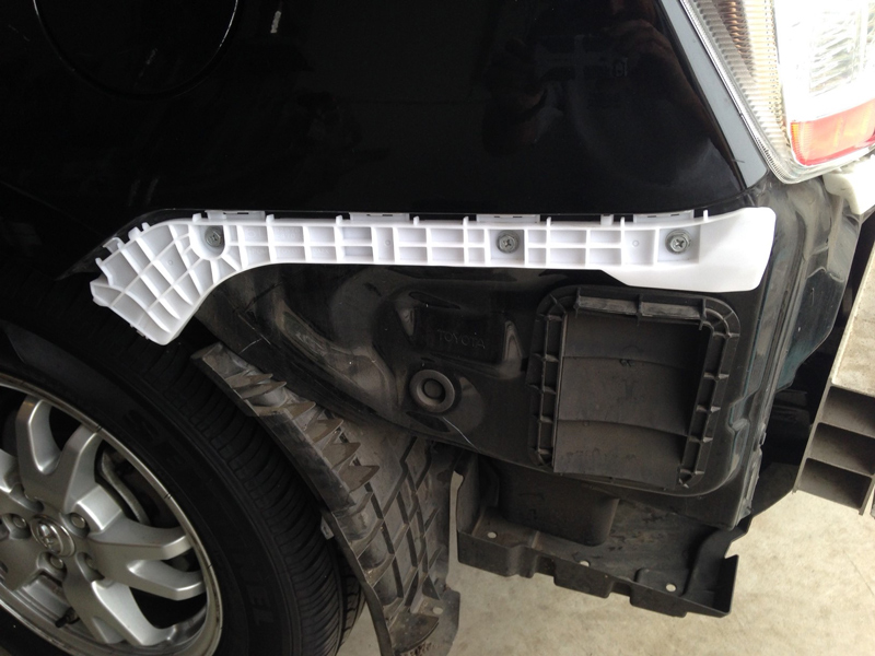

    My son bought a 2010 Prius recently and went through issues with the side of the rear bumper cover coming loose. The dealer did work on it and replace the cover because one of the tabs was damaged. Unfortunately they did not replace the side retaining clips and he still had issues. I decided to pull off the cover, and trouble shoot it a little more myself. I did discover that Toyota released new newer version of the sider retainer for the 2010 and up, (part #52575-47021 right, and #52576-47021 left) but very little changed in the design.
    The actual problem is a two foot span in the middle of the bumper has no support at all, it's a poor design. The plastic clips by the tail lights and on each side don't do a good job of supporting any type of vertical load. If you happen to sit near the rear cargo area or put weight / down ward force near the top center of the cover you will either damage the tabs in the cover or the clips themselves.
    I ended up replacing the sider retainers with the new parts and also made a small support for the center area right behind the latch for the hatch itself. There are two exposed studs that I used to mount an AL bracket (2X2X8.5”) for additional support to avoid future damage of the clips and having the gap come back. I took a couple of photos if anyone has any questions let me know. I just did this mod, so I don't know longer term how it will work out, but now if you press done on the top middle of the cover it does not move. So hopefully this will take care of any small loads from him simply sitting in the rear cargo area with his legs on the cover.

    I have to replace the passenger side retainer on mine & I think I'll add the center bracket as well like you did. You mentioned two exposed studs, are these studs readily exposed soon as one takes out the bumper cover & was that a 1/8" thickness AL bracket that you've used. Thanks.

    I can't tell what's going on in the picture either. Just went out to look at my car. Both sides look the same. Both sides look like the picture. Maybe I'm sagging on both sides? Beats me but the fit is acceptable to me.

    Mine is just as bad, I purchased the part that holds that section of the bumper, assuming mine was broken, but it was not, the material of the shell is so flemsy at the mounting points, that it just does not hold.
    This is what toyota calls quality, but it's actually far from it.
    Your best bet might be super glue on the mounting points, I have not tried it yet.
