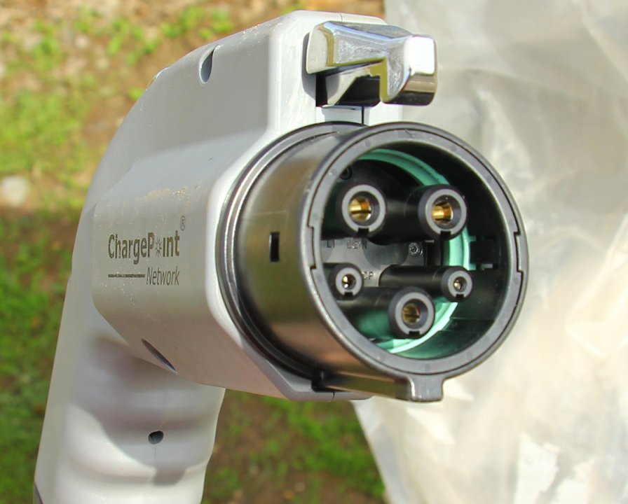

    If you look at my avatar you can see it- that "O" ring is greenish..
    On my actual OEM Toyota handle it's orange.
    114,087
    51,968
    i would think it's a weather seal, but it might just be a cushion when the plug seats.

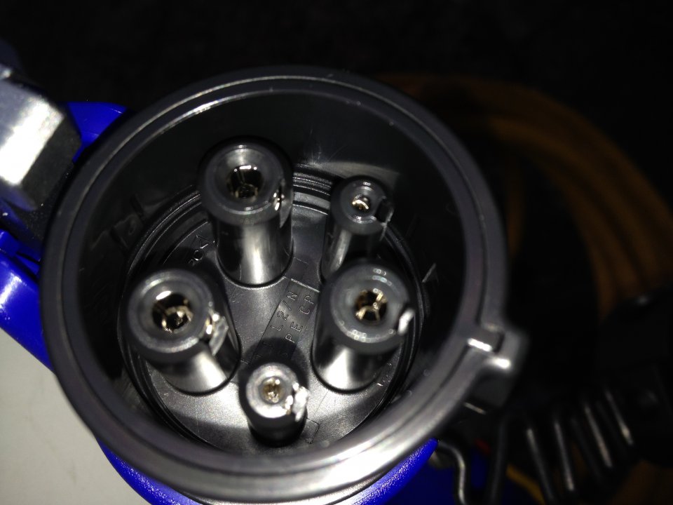

    My handle is a blue SVCC Sumitomo. The inside of my black plug looks just like yours, except where your green seal is, I have an empty ≈3/16" groove around the I.D. Does everyone have an orange or green seal in that groove?
    (Leaving no nit unpicked, I don't think it's actually an o-ring ... a gasket in the form of a ring with a circular cross section... ;) )

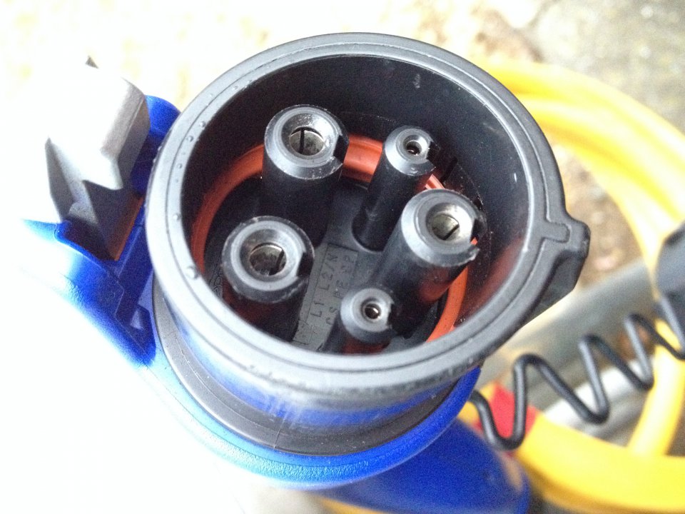

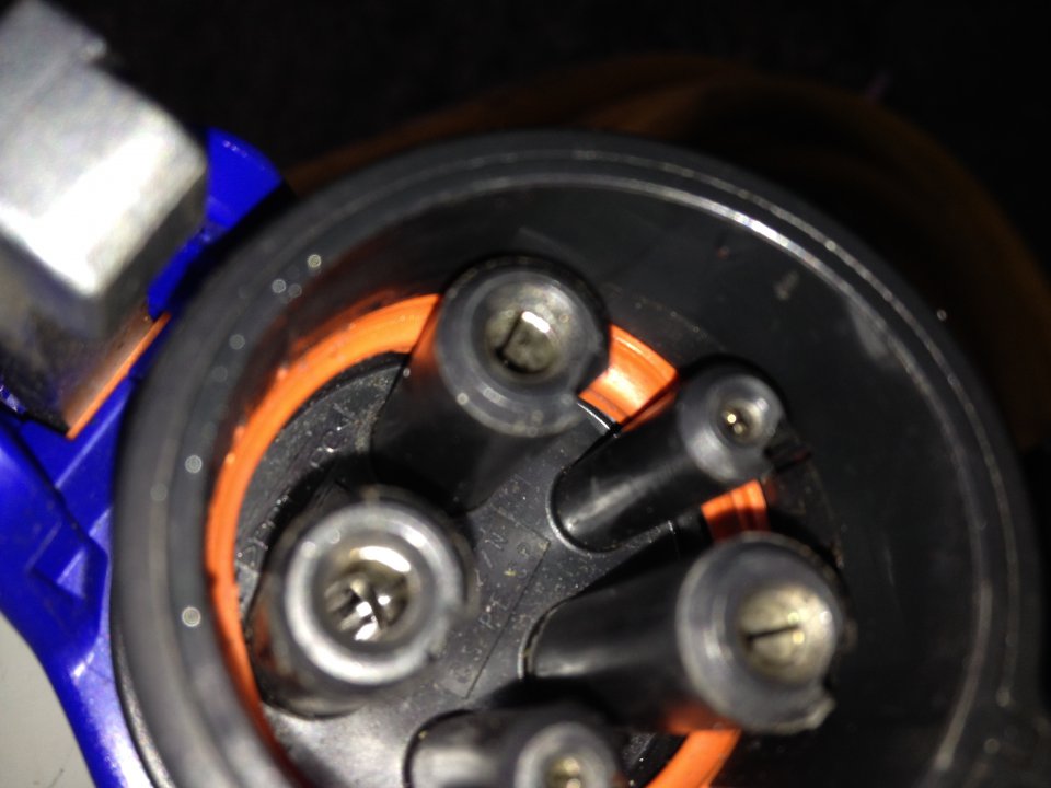

    I checked my OEM EVSE wand and it has an orange ring inside and it show to be sort of deformed by use. Daily use after 20 months.......

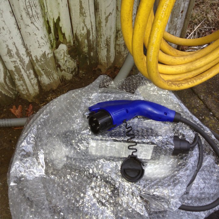

    I have another OEM evse that I bought out of ebay,(unknown Prius model year) brand new to carry in the car in case of an emergency/convenience recharge, and it doesn't have the sealing ring inside of the wand. It must be a moisture prevention device.
    I'm including some pictures

    Mine has the orange o-ring inside as pictured by mrbigh.

    My 2013 PiP OEM charge handle has none but I have had no problems (after only a month:D)

    Same here orange o-ring.
