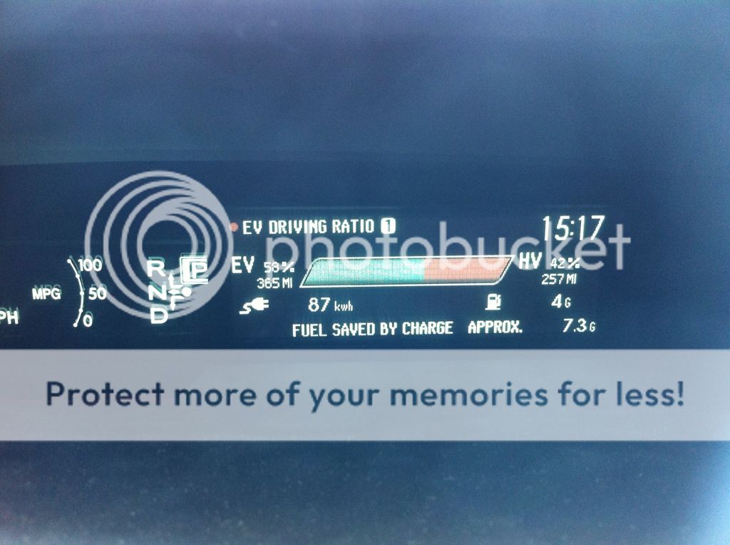

    I sent an email to "pb" from Fuelly, describing a method for Fuelly to add "KWH" data to Fuelly, so they could use it to calculate MPGe, using the EPAs formula, I received a reply, that they will look at the data, and consider it. I add the "KWH" consumption at each fillup to the "Notes" field in that Fuelly entry, I then reset my "EV Driving Ratio 1" display..
    see the email I sent below:
    Hi there,
    I just read the thread on tracking KWH for Plug in Vehicles:
    http://www.fuelly.com/forum/968/Electricity-kWh-Fuel-Consumption-and-MPGe
    I do have some information on this, as I bought a Plug in Prius about 1 month ago.
    The PiP tracks KWH usage on the multi information display, and there are 2 separate "EV driving ratio" trackers. I have my #1 tracker setup so every time I fill up with gas, I take a picture of it, and then reset it. My #2 tracker I never reset, and that is tracking my total lifetime KWH, and total lifetime gasoline consumption etc.
    What I have been doing with my fuelly account is entering the "KWH" # in the "notes" field each time I fill up my gas tank... because that's also when I reset that statistic as well.
    If fuelly had a way to read that notes field, and there was a symbol that represented "KWH", you could use that # that we enter to calculate MPGe, using the EPA formula (which is documented)
    this way, just let the users enter their KWH consumption at the same time as they fill up with gasoline. This will work well for vehicles like the Plug in Prius, and the upcoming Ford Energi Plug In, because we only get 11-15 miles/charge on the PiP, and the Energi is supposed to get around 20 miles of EV per charge, so we tend to go the the gas station every 2-3 weeks, depending on our drive cycle. I have only filled up twice, and I have owned the PiP for 1 month, and driven 1325 miles.
    I'm not sure the Volt owners would like this, as they tend to hardly ever fill their gas tanks, as they have a 35-50 mile EV range, and many just never need gasoline. So perhaps they could make a "zero" entry for gasoline usage, but put in the KWH consumption in the "notes" field, the same way we could.
    I am enclosing a Photobucket link to a picture of the Multi information display "EV Driving Ratio 1" display on my Plug in Prius, from the fillup I just did today, so you can see what information is tracked/availble. You will see I used "87" KWH, and I drove 365 miles in EV, and used 4 gallons of gasoline, driving 257 miles on that, it also shows the EV/HV percentages, I am at %58 EV / %42 HV since the last fill up (2 weeks ago), and If you add the 2 numbers together, I drove 622 total miles, since the last fill up as well, it even has an "estimated fuel saved by charging" #, mine shows as 7.3 Gallons since the last fill up.
    "EV DRIVING RATIO 1" (current tank, zeroed at each fillup)
    "EV DRIVING RATIO 2" (lifetime, never cleared)
    thanks for taking the time to read this, and I hope Fuelly can eventually be updated for Plug In Hybrid vehicle tracking, as the KWH are needed to get a true MPGe for anything that plugs in.
    "pb" from Fuelly's reply;
    Thanks for taking the time to share this info, it's very helpful. I've forwarded it on to Matt (my Fuelly partner) and we'll include it in our discussions about adding KWH. I really appreciate it!
