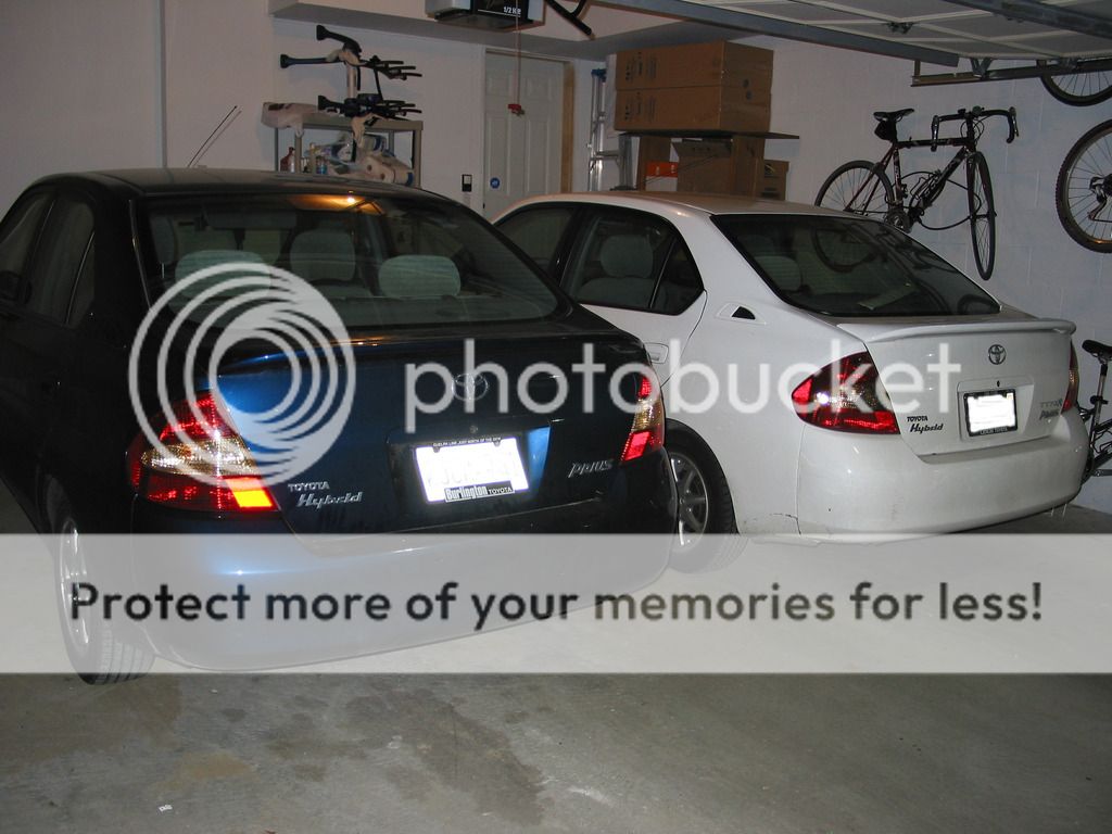

    BTW, at that time, I lived in a downtown Toronto condo townhouse, with a shared garage with my neighbour. Given that my Prius (Type R ;)) was quite rare at the time, I was shocked one day when I went into the garage to find this:
