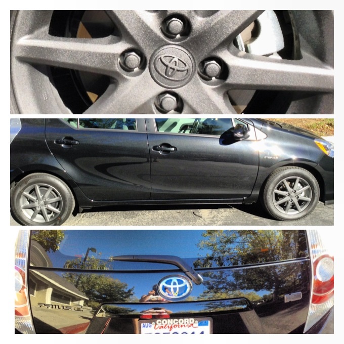

    So i recently been looking into plasti dip and stumbled upon some idea after watching videos i seen the same guy fonzie from dipyourcar after watching vid after vid i decided it was time to get a dippin. 2 weeks after my kit i finally received the kit including 4 anthracite grey 1 clear coat (only color they say to do 1 clear coat) and 1 smoke to play around with...
    Note : need to dip in a non dusty area !!

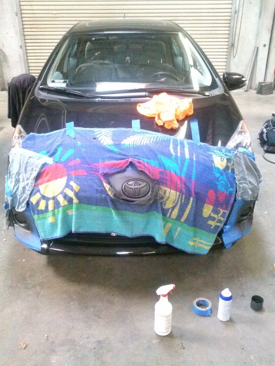

    Called my dad told him i need his garage to dip got the okay and my journey was started. The kit also came with a kit to dip your wheels while they are still on the car ! 4 standard garbage bags and 1 cleaning solution to clean wheels before you dip. If used with water you need to wait to dry vs using there solution which is no wait. The journey i say was a learning process as wheel as an easy journey. If you used spray cans you will have no problem! The kit came with bags to cover up your rims covering rotors and brakes make sure you cover everything you dont want sprayed but miner spray will rub off easy with goof off.Tire shine your tires from overspray peels right off after.I started 50 percent tran. for the first two coats of grey next. The next three where very thin but heavy layers. Make sure your last two sprays you drive the car forward or back 3 feet to make sure you dip every spot even. Now the clear coat you want to make sure you do it right the first time noting you only need 1 coat unless you want a major polish look and feel. 1 heavy coat of clear and i was ready for the logos .......make sure you wait 8 to 10 min to dry each coat and final i waited hour n half should wait 2 but my garage was very hot and the heat helps your dip settle.
    Tapped up logos with blue painters tape wide range and put towels on the car to protect from over spray. Did about the same technic with the rims just way easier because you not dealing with more space. Peeling off after is the tricky part.... Wrong so easy it peels off like rubber glue if there is anything lol. Just take your time going around the logos the dip will auto cut itself when peeling off the dip from the surrounding areas. Go to YouTube and watch the video on logos .
    The metallic in the grey when it is done gives a flake in the sun witch matches so perfect with my paint black sand pearl. Next i might plasti dip the front grills and order shark fin and dip that same color. Lmk what yall think !! View attachment 57548 View attachment 57547 View attachment 57548 View attachment 57549 View attachment 57547 View attachment 57548 View attachment 57549 View attachment 57547 View attachment 57548 View attachment 57547 image.jpg View attachment 57569 View attachment 57570 View attachment 57571 View attachment 57570 View attachment 57571 image.jpg image.jpg

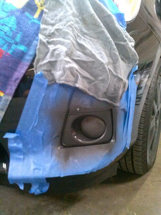

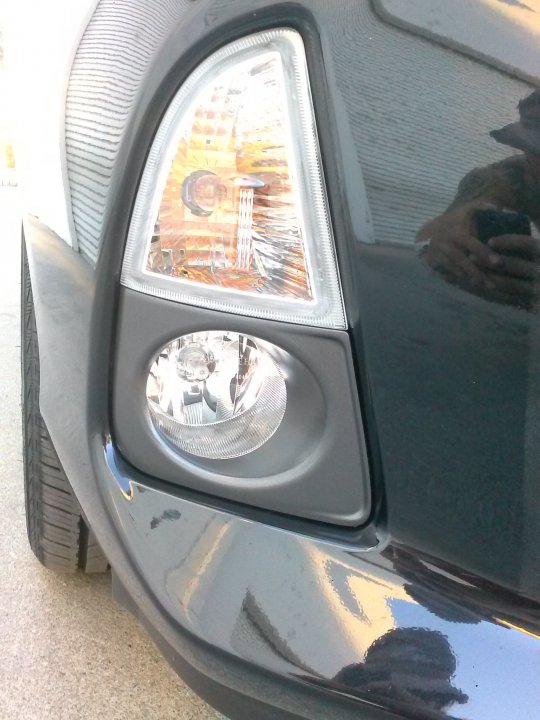

    Going to post up pics of fogs dipped and also dipped my main logos to match !! Long day got off work 4 and dipped at my work yard :) so i finished logos and fogs in hour and half and waited 2 hours to dry just because im waiting on my girl to pick up from bart lol W CAM01379.jpg
  14. Billy joe
    Billy joe New Member
    Sep 15, 2013
    27
    Pittsburg California
    2013 Prius c
