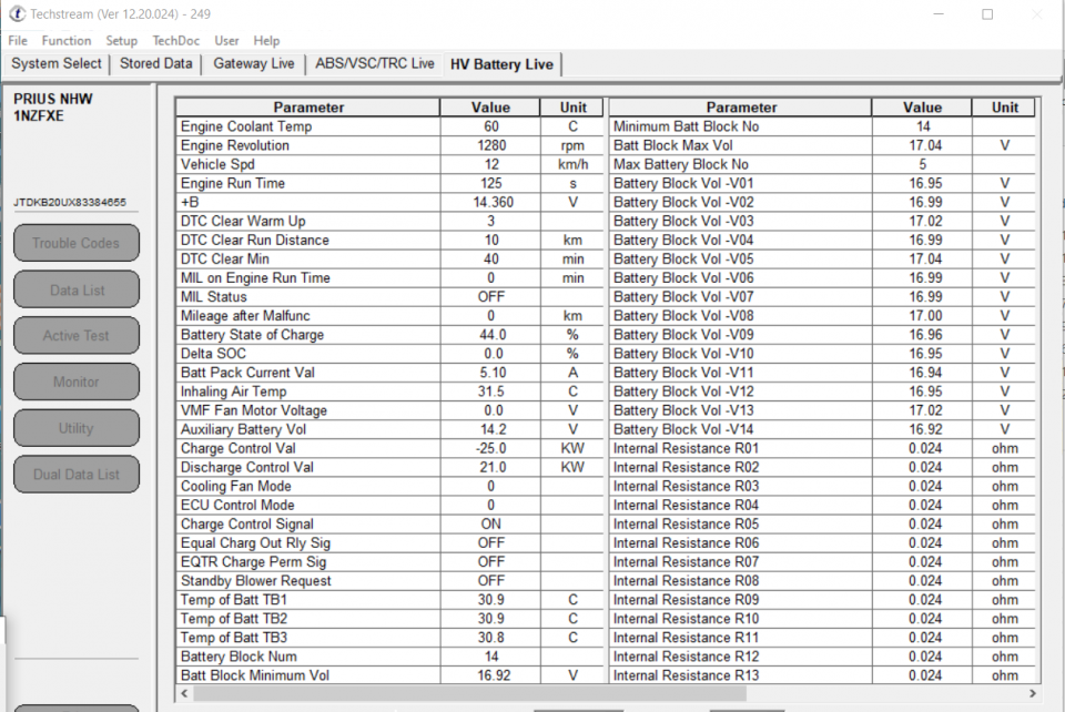

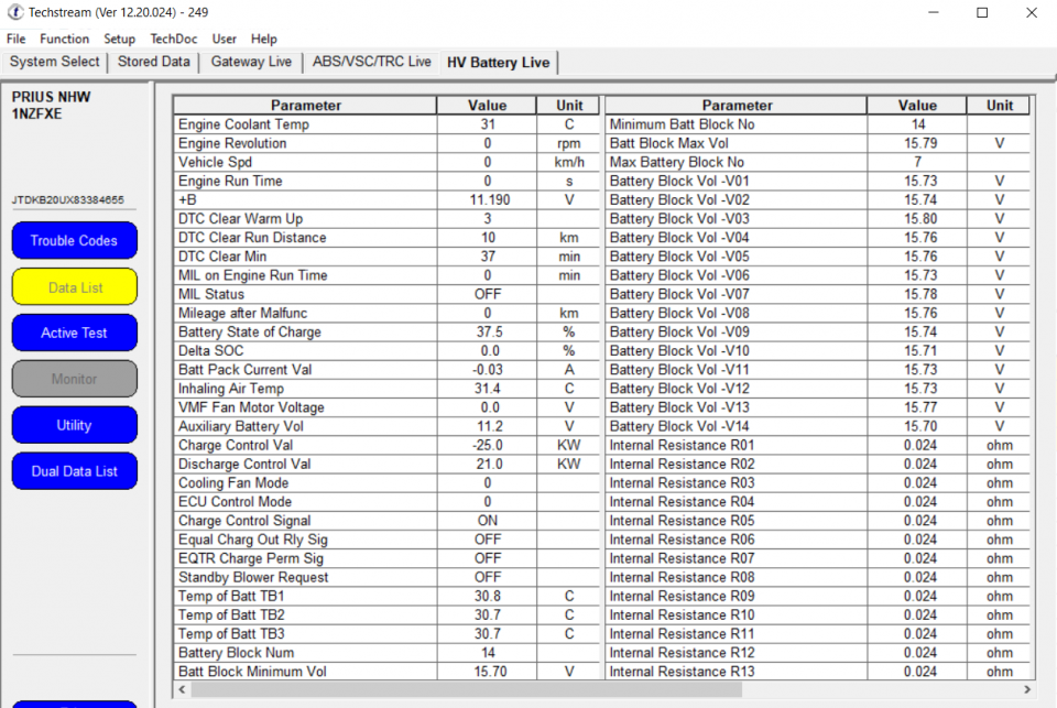

    I used Prius as my second car. Once or twice a week. And I checked Techstream metrics after staying for a week in a parking lot and after driving around 5 miles. I attached screenshots here.
    I found (thanks forum) 2 ways of maintenance of big battery life:
    1. Using grid charger (Maxx Volt, Prolond, DYI etc).
    2. Replacing some modules in the battery.
    Could you advise me which way is better for me (and my current metrics)? or both?
    I don't see that any modules have a huge drop from others.
    PS.
    Looks like 12v battery is dying as well (shows only 11.19V after staying one week) :(

    if you're not getting any trouble lights, i would use a grid charger
    there are many other reasons why a prius loses gas mileage as well
