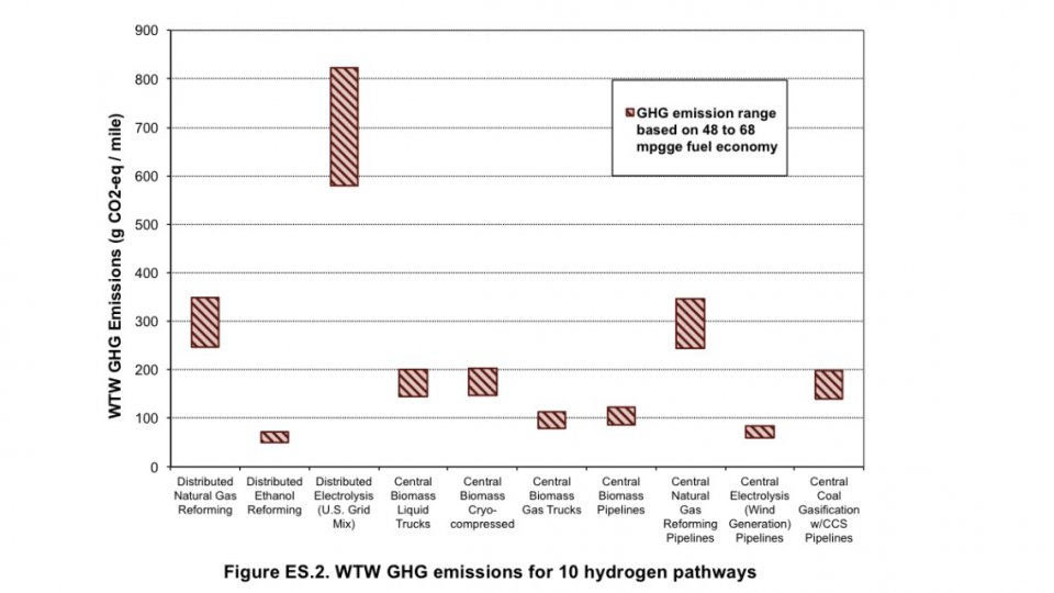

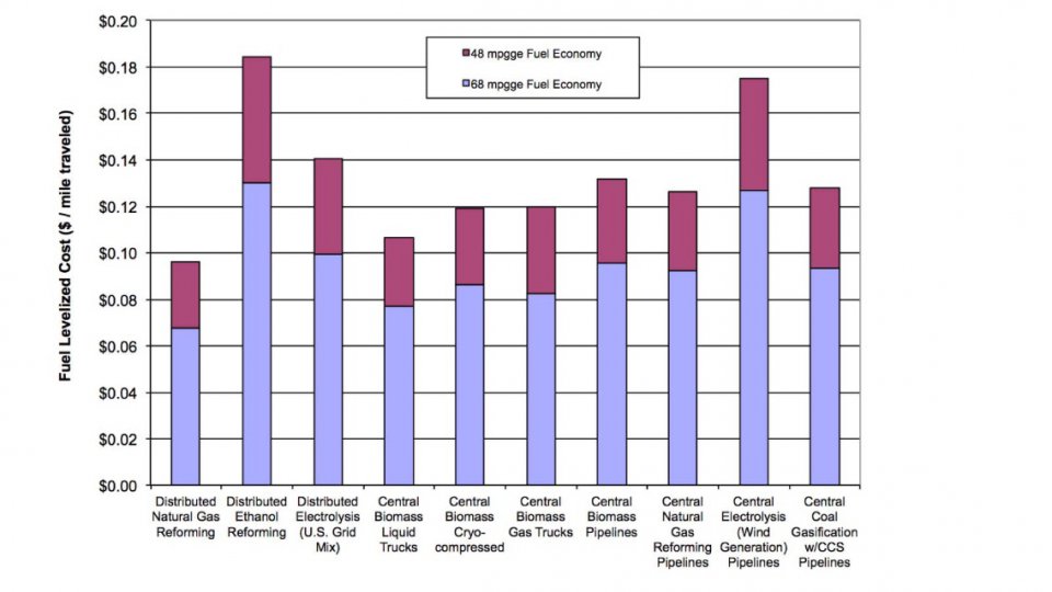

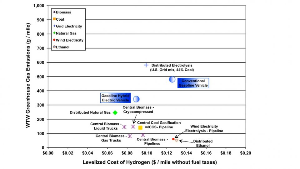

    Here are 3 graphs from a recent (2013) US national labs (NREL) report on hydrogen production efficiencies, emissions, and costs.
    The "Gasoline Hybrid Electric Vehicle" shown on one of the graphs is not a Prius -- it's shown as having ~350 g/mile of CO2 emissions so it's ~33 mpg whereas a Prius has about 222 g/mile at 50 mpg. It most likely represents a hybridized version of the "Conventional Gasoline Vehicle" shown on the same slide that gets ~24 mpg. This version of the graph shows the CO2 emissions of a FCV getting 68 miles on a kg of H2 which is roughly around what the 2015 Toyota is likely to get (there is another graph showing a 48 mile FCV which I'm not posting right now).
    The bottom line is that a 68 mile per kg H2 car would having emissions of 250 g/mile CO2 which is slightly worse than today's Prius when using steam reformed natural gas. Another graph shows this to be the cheapest way of producing H2 and it is how almost all H2 is commercially made today. Renewable bio sources of H2 are not that much more expensive but then you could use the same bio sources to make renewable electricity instead.
    These are taken from:
    "Hydrogen Pathways
    Updated Cost, Well-to-Wheels Energy Use, and Emissions for the Current Technology Status of Ten Hydrogen Production, Delivery, and Distribution Scenarios"
    http://www.nrel.gov/docs/fy14osti/60528.pdf

    For added context, the NREL graphs show a 68 mile per kg H2 car emitting 250 g/mile of CO2e. FuelEconomy.gov shows a Volt on US average electricity (which is about the same as marginal NG generation) also emitting 250 g/mile based on its projected Utility Factor of grid recharged battery vs gas engine usage (which is consistent with OnStar statistics).
    A Cadillac ELR is shown emitting 290 g/mile (in CA it is shown emitting 230 g/mile). A Hyundai Tucson FCV gets 47-49 miles per kg so NREL would project 350 g/mile emissions for it.
    So, again, why are we distracting ourselves and wasting all this money and engineering resources on fool cells for passenger cars?
